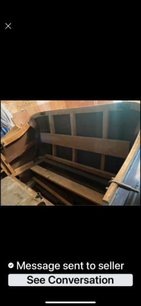

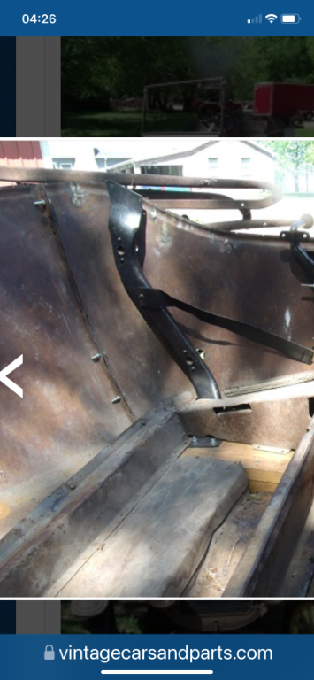

What are these black upright brackets called ? My 23 touring is missing both. Are they available ?

Those brackets are for the fender and top supports. Reproductions are not available, but used ones should be easy to find. Check with Model T Haven.

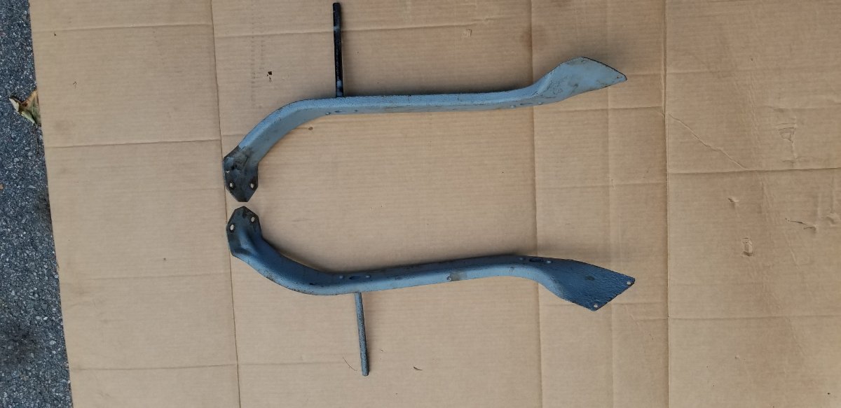

Hi John,
I have a pair of those brackets which I will never use.
Please email me, if interested, at: billsmodeltshop@gmail.com
Located in New Hampshire.

John,

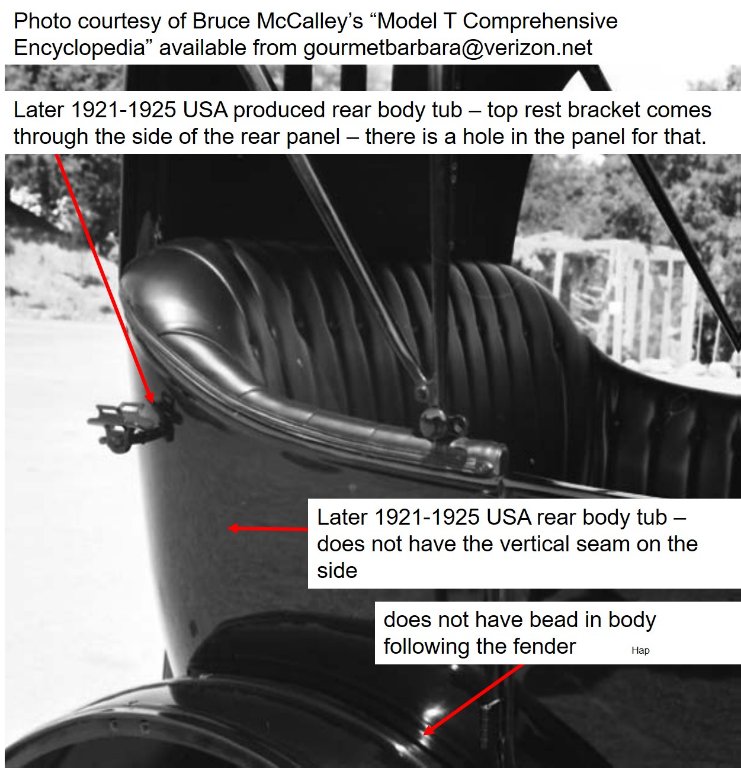

Summary: Welcome aboard! I think you will enjoy your T and the friends you will meet and make along the way. If your car body is a 1922 Canadian produced touring I do not think it needs that bracket. If it is a 1923 Canadian produced touring I don’t know if it does or does not need that bracket. The 1924-25 produced Canadian cars appear likely to use that bracket.
I believe a good clue is if your car has a hole on both sides of the rear seat panel for the straight top bow saddle support arms to fit through. Note a 1924-25 Canadian rear seat section can be grafted onto a an earlier Canadian touring body to replace the rear seat section if it was damaged or missing. And I’m sure that a late 1921 to 1925 USA rear seat section could be grafted onto a 1915-1925 Canadian touring body with minor modifications. Note the later 3 piece rear section has a slightly different body molding that does NOT match the earlier 5 piece rear seat section. It will function OK but the molding and the width of the arm rests are different. Below is a photo of a USA 1917-early 1921 5 piece rear panel and a USA later 1921 to 1925 3 piece rear panel. Notice how the top support bracket comes down from the top of the rear seat on the earlier USA bodies and out through the rear seat side panel on the later USA touring bodies. (That is also true for the USA runabout/roadster bodies but they switched to the new style a few months later than the touring cars.)
More details which hopefully will be of some help to you.
I plan to put up a posting this weekend on why I believe the 1922 and earlier Canadian tourings did not have that metal support you requested information about. And to ask if anyone has information on when Ford of Canada adopted the three piece rear seat panel that also used that part. And to confirm that all the 1924 Canadian cars had the three piece rear seat panel or to correct that guess and establish when the three piece rear seat panel was introduced. And how much overlap was there when both styles – the 5 piece and the 3 piece rear seat panel was used on the touring bodies. I will put a link to that posting here when I post it. Or if you post that question – please put a link here so I will find your new posting with the questions.

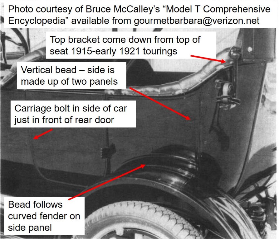

For the USA production the bracket you are looking for was introduced when the bodies moved from a “5 piece-panel” rear section to the 3 piece rear seat section sometime during early 1921. And for those 3-piece panels the top rest support arm came through the side of the panel rather than down from the top of the rear seat as the previous 1915-early 1921 cars. (See Lang’s 3858B at: https://www.modeltford.com/pl.aspx?t=s&v=3858B&page=1 Note – Lang’s as well as some of the other vendors often (but not always) use the original or close to the original Ford part numbers. ) (And yes, the 1914 and earlier cars had the same top rest support “L” shaped arm.) Some photos of your body showing the rear panels would be helpful and should let us know if it had that hole in the side for the top bracket or not.
Because Ford of Canada supplied most of the British Commonwealth countries, there is a one single family owned since new 1922 Canadian touring in New Zealand with a known history. It has the “5 piece-panel” rear section. And it does NOT use that USA styled bracket you are looking for. Why? Because Ford of Canada continued to use the same wooden rear seat riser construction from 1915 into the 1920s. They also continued their “clamp style” top holder that attached to the top of the rear seat panel. See postings by Alex Brown at: Model T Ford Forum: Single Family Cars...? (mtfca.com) And at the posting: http://www.mtfca.com/discus/messages/29 ... 1205709920 he shows the wooden rear seat section from inside the car. It does NOT use that support you were asking about. You can also see the top hold down supports.
