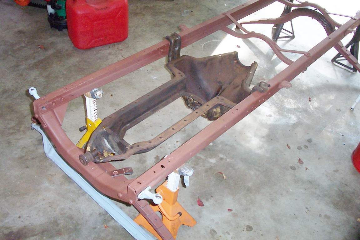

- Posts: 4110
Re: MOUNTING HEADLIGHTS ?
Go to the "Hay Wagon to Speedster Project' thread, about 10 threads down.
Scroll down to Thursday Dec 10, 2020 1:39am post.
There you will see photos of amputated frame horn for the '26-'27 fender mount. Then drill holes to mount the earlier fender/headlamp bracket. Cut of the fender iron to suit, just above the lamp mounting hole.
Photo of cut off pre-'26 fender bracket to mount just the headlamps.
