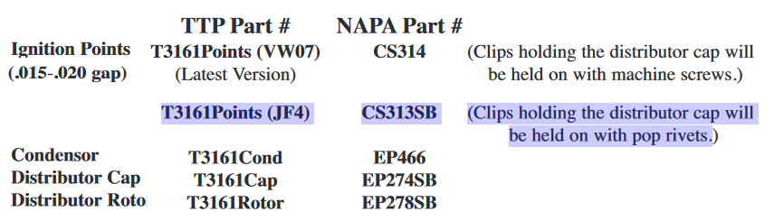

If your distributor has had this modification already, you can tell as the cap hold-down clips are pop riveted to the distributor.

Some of the earlier Texas T distributors had screws that held the clips on. Those require a different set of points. Seems to me I remember having the different points and had timing issues like are being discussed. Changed the points to the proper configuration as is described in the Texas T instructions, problem solved. They are good units and do a great job with little or no maintenance.

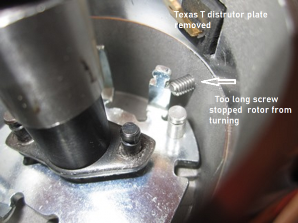

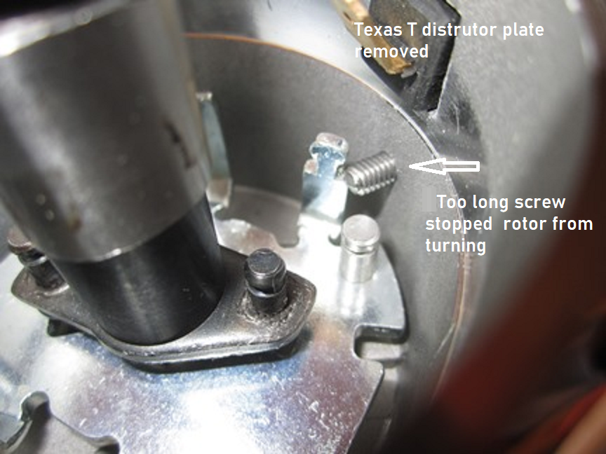

Just to provide some closure here, we figured it out. It had nothing to do with anything on the T engine or timing gear, it was all in the distributor head itself. And of all the crazy things…
Let me start with just a bit of backstory. We bought this T from a guy who bought it at an estate sale. He didn’t know anything about T’s but thought he’d work on it. After 5+ years in his garage and never doing anything with it, he wanted the space so he sold it. Point being, we didn’t know much about T’s when we bought it, and neither did the guy we bought it from.
It looked like it had a Texas T distributor on it. The bottom part had Texas T stamped right on it. So we followed the directions from the Texas T site to time the distributor, it worked, and we went with it. The car has been running on and off the last year. It never, until 2 days ago, occurred to us that this wasn’t a true Texas T distributor. No one ever shows pictures of the inside, just the outside.
In talking with others, Ernie finally realized that while the base was Texas T, the head was a VW Bosch distributor that had never been modified to make it work with a T. It had none of the modifications people were saying should be there to make the Bosch work on a T. And yet the car had been running for the last year!! How did it manage to run, and what changed? That’s been our head scratcher for the last week.
Here’s what we think. Someone, somewhere in the past, picked up a Texas T base, then fiddled with a regular Bosch distributor until they got the rotor to ride on top of the mechanical advance weights in just such a way as to spark in proper time. It actually positions the rotor so it just catches an edge, but was close enough for the spark to make the jump pretty consistently. It fit snugly enough in that position that it stayed in place over the past year. We think it was probably a bit seized from being in that position for years while the car sat idle. But then, over a few days, it started to break loose. Hence the increase in engine sputtering. And then it dropped into proper position where the spark could no longer connect as it was not modified to do so.
That perhaps sounds a bit crazy, but it’s the only explanation we can find to fit the scenario.
Ernie took out the point plate. There are 2 small arms on the sides of the mechanical advance that he was able to bend toward the center to keep the mechanical advance from working. Then he drilled 2 new holes in the distributor head body so he could rotate the point plate to where the points open properly for a T. Put it all back together, and the T runs better than ever. It starts easier and runs smoother.
So I suppose it shows, yet again, never assume anything!

Here is why, a true VW Bosh 009 distributor had a vacuum advance. It was a popular, cheap head, modification to make work on a Model T
TEXAS T Distributor has mechanical advance but was/is NOT a VW 009 distributor head. This is their description
"Although this unit uses a custom made distributor head, the points, condenser, rotor, and distributor cap will interchange with distributors commonly used for production vehicles. The head is keyed and will only fit in one position"
Found this link with a picture of the parts under the plate for a Texas T. http://www.mtfca.com/discus/messages/50 ... 1427237901
