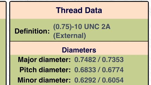

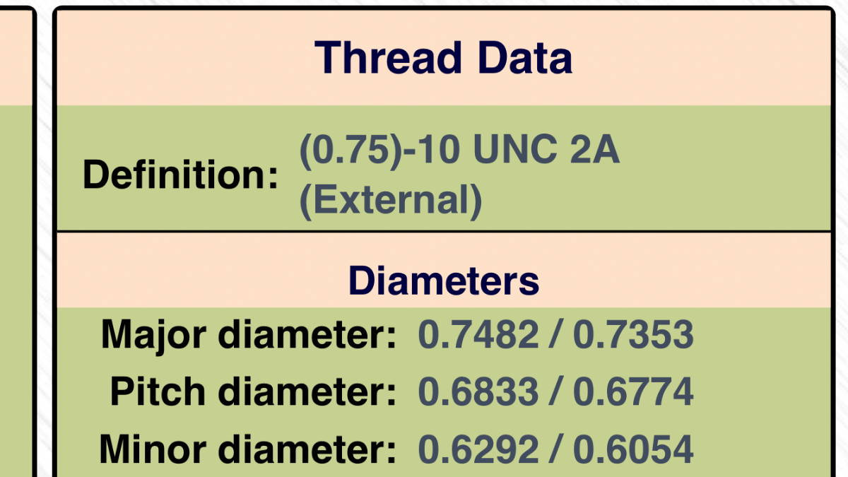

There is a tolerance connected to the major diameter of screw threads.
For a 3/4 10 external thread the max is .750 in.
The minimum diameter is .735 for a class 2 thread..
And .737 for a class 3 thread.
Often you will find that the major diameter is below the minimum, particularly with economy applications.
Art Mirtes
