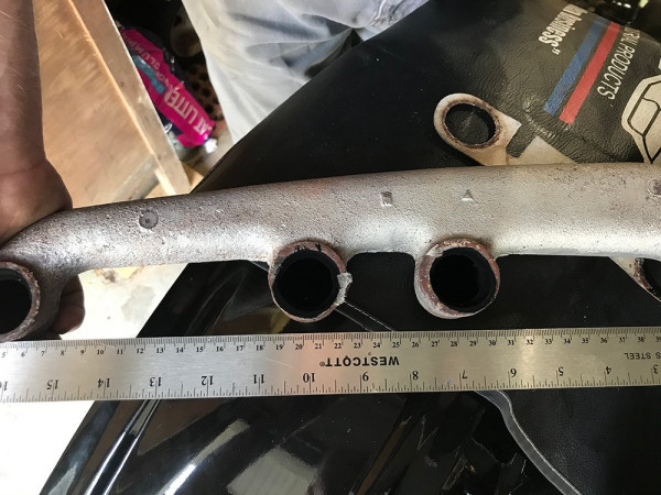

Whaddya think? Is this manifold a little warped? Easy to straighten, right?
Re: Manifold Droop
Post by Norman Kling » Wed Oct 06, 2021 8:46 pm

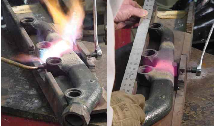

Not so easy. Has to be heated up in the areas of the bend and bent into shape. Many times they will crack in the process.
That manifold looks very thin at the two center ports like someone might have ground the holes at one time.
It is time to spend a few dollars and buy a new manifold. Then whatever type gaskets you use, be sure to place the glands to hold it in place when it gets hot so it won't bend again.

You could use that manifold to develop a technique (see below) - but as the man said its a but thin around the collar
Some old discussions on how to do it
Method 1
http://mtfctulsa.com/Tech/manifold.htm
Method 2
http://dauntlessgeezer.com/DG82.html
Method 3
http://www.mtfca.com/discus/messages/331880/342833.html

The manifold came off my friend Gene’s ‘22. We took one look and ordered a replacement. :D It’s been one thing after another....frustrating! I guess that’s the Model T experience you keep hearing about.
Soot stains make the openings look like the walls are thinner than they are. Unfortunately, the PO used one-piece flat gaskets that don’t have glands with the result that one end of the intake manifold leaks too. We’ll use the good ones when we put the new manifold on.

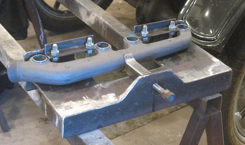

I have tried to straighten a couple of them. Not successful yet. One of them suffered from a shifted sand core, was almost 3/8 inch thick on one side, nearly paper thin of the other side. It snapped instantly!
The other one was tough. I actually made a jig and clamp to press it when heated. Never got it hot enough to bend but boy was it HOT!

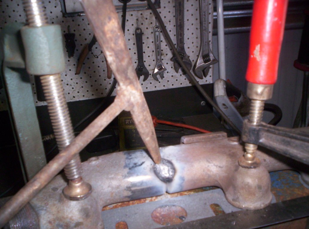

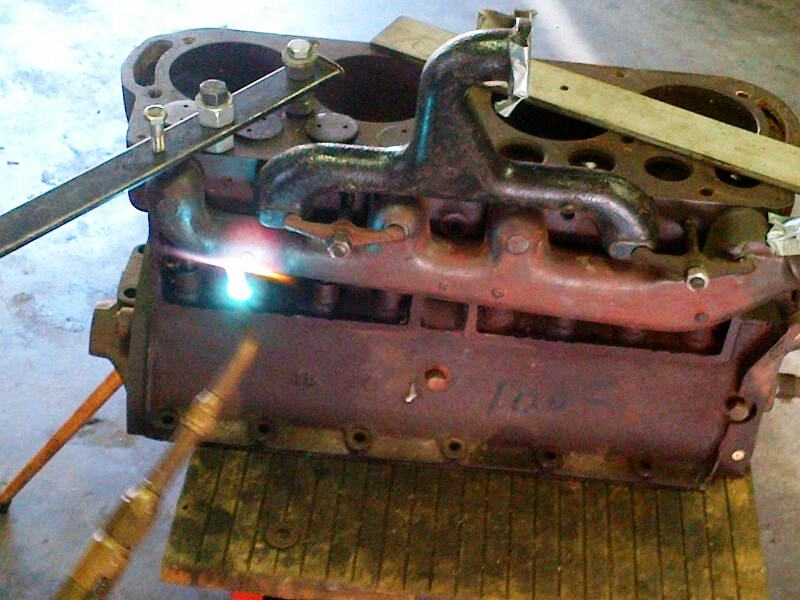

The last one I did was that far out it would never re-shape with heat, so I did a cut'n'shut on it. Cold cast arc, 1/2" at a time with a lot of peening.

I have seen a couple that were cut between the second and third ports, and welded back together. If you can stand the appearance of the weld, it is not a bad idea. Easy to get two pairs of ports into a straight line. With the two pieces bolted to a block with gland rings to hold the line, it should be OK. One that I saw was welded, the other bronzed.
