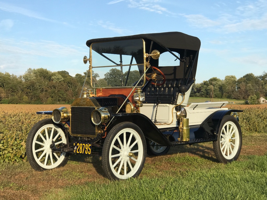

can a buckboard pick up be put on the back of a 12 torpedo roadster?
TBones12
Topic author - Posts: 183
- Joined: Tue Jun 18, 2019 2:20 pm
- First Name: Robert
- Last Name: Poane
- * REQUIRED* Type and Year of Model Ts owned: 1916 Hack, 1910 Touring, 1914 Touring, currently a Touring 1912, 1912 Torpedo Roadster
- Location: Baltimore
I asked this before and someone was kind enough to respond but I forget who he is.
I would like ot PM him if he responds again.
The pick up will extend about 18 to 20 inches I think. If so, won't that potentially crack or break if someone sits on the tail?
I would grateful if someone posted pictures of their converted 11-14 converted roadster pick up, especially the side view.
What gas tank would go under the front seat? A round 1914 tank maybe?
The battery if you install one would be accessed through a cut out in the back of the pick up I imagine?

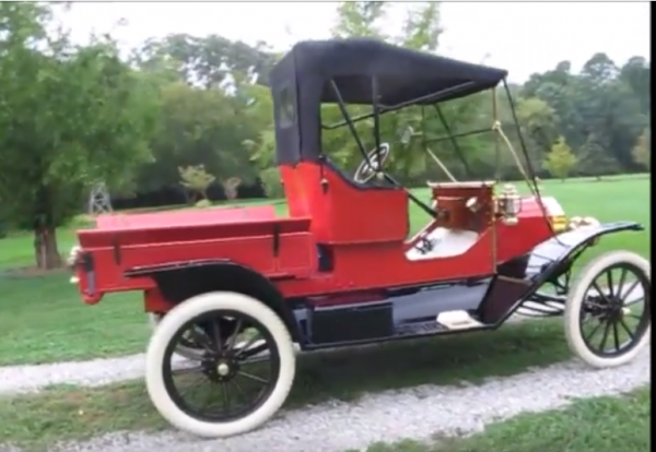

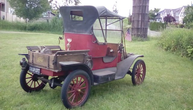

I did a search to get some pictures of what the configuration might look like. Some are not of a Torpedo body but I would expect driver position etc to be relatively the same. The corresponding link is above the picture
https://journal.classiccars.com/2020/07 ... e-day-tom/ http://classiccardb.com/ford/270532-ant ... ickup.html https://topclassiccarsforsale.com/ford/ ... dster.html Here is another option. There are several salesmen boxes out there. I know where one is. Think it would be unique and cool looking on a Torpedo.
http://www.mtfca.com/discus/messages/11 ... 1293029919 http://www.mtfca.com/discus/messages/80 ... 1247510850

Thank you Frank, for going out of your way to research these pictures!

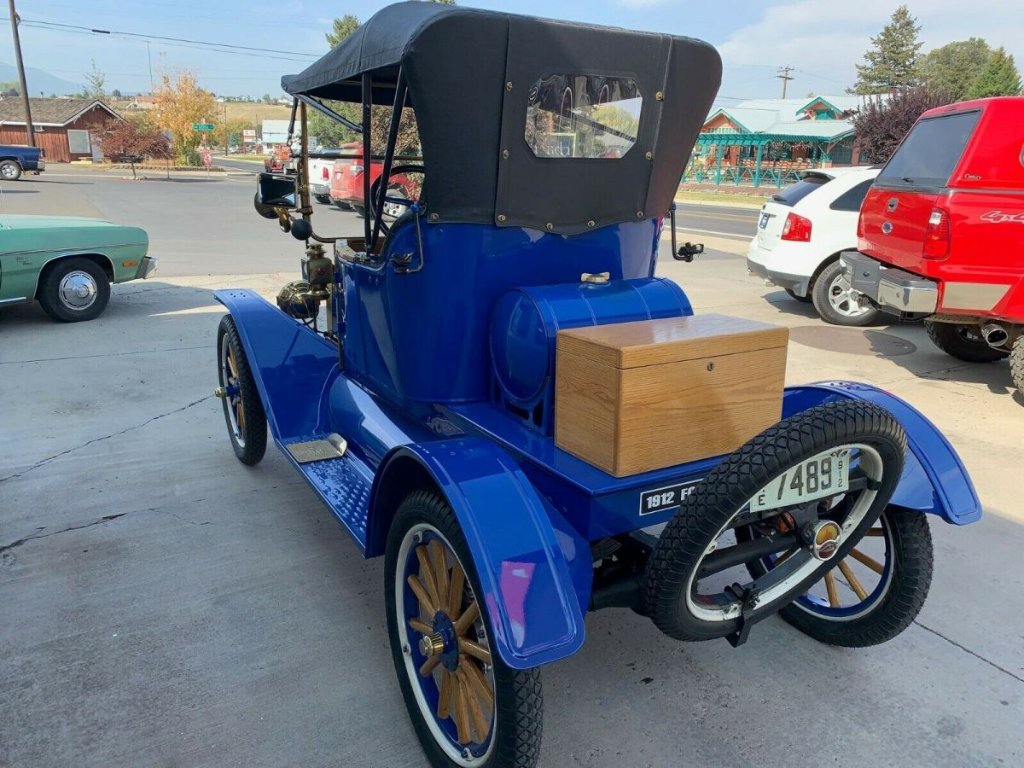

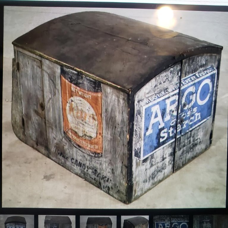

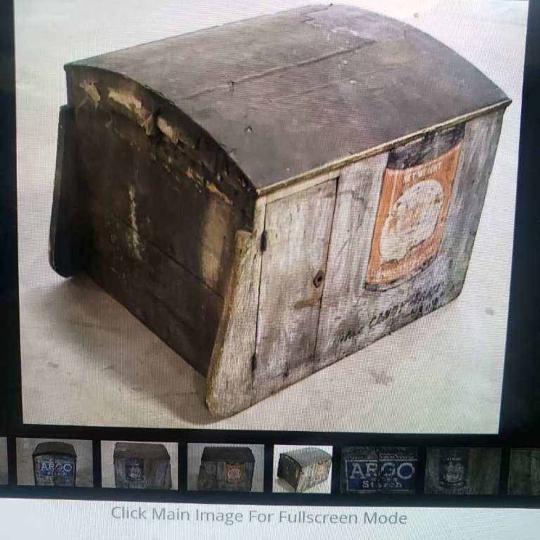

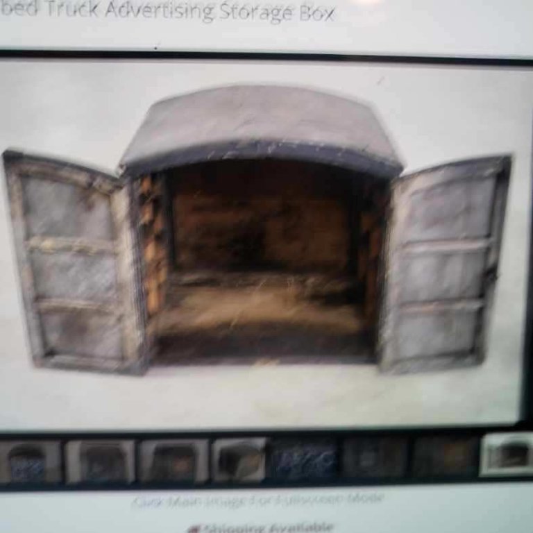

Here are some pictures of a salesmen box that a friend is bringing to Hershey . If interested email me and I'll give you his #'s. Don't have the dimensions but it should fit on the platform behind the body

Re: can a buckboard pick up be put on the back of a 12 torpedo roadster?
Thanks for sharing. Very neat! I am going to go with the buckboard concept.

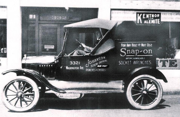

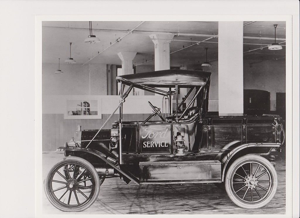

There is historic precedent for doing so.

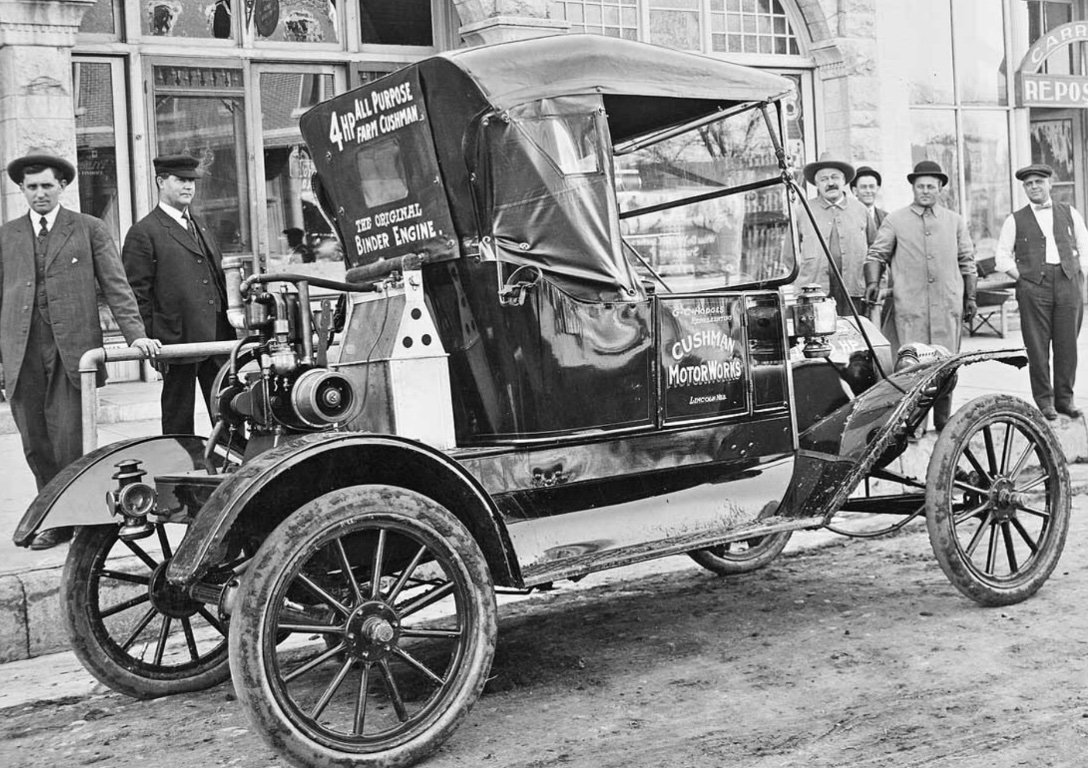

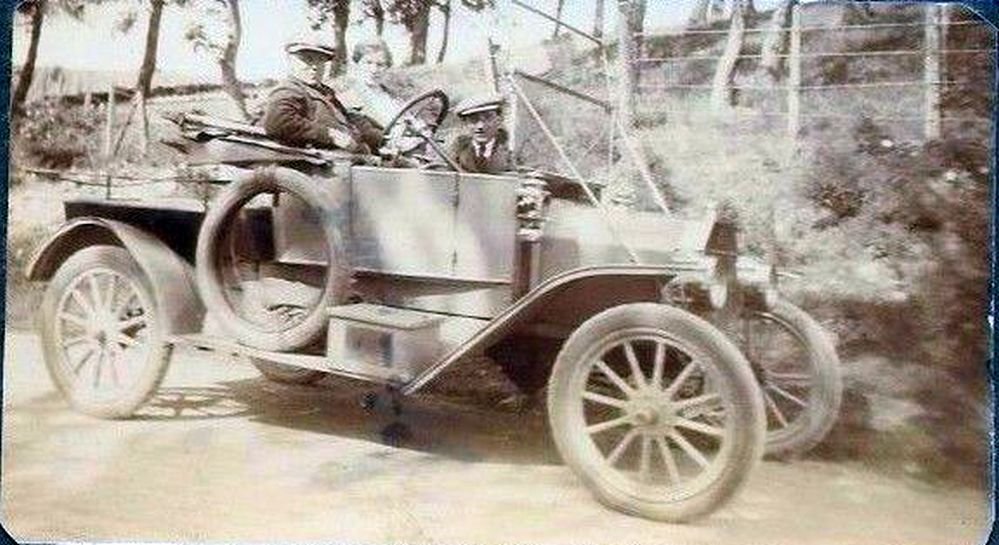

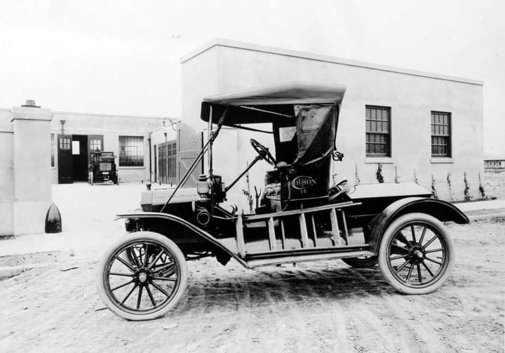

I recalled seeing a couple era photos showing modified torpedo roadsters. So I went looking for them in my terribly unorganized harvested photos file (sorry I do not know who posted these originally, but they have actually been posted several times before!)
This first one shows a fairly new torpedo roadster with a demonstrator Cushman farm engine mounted on the back. The gasoline tank has been relocated somewhere?
This next one shows a torpedo roadster, a couple years old, with some sort of deck installed on the back. The original torpedo gasoline tank would not fit under that deck, so whether the tank was changed to a smaller one and relocated under the seat? Or the smaller tank is under that deck? We can only speculate? Notice that the deck has a railing around it like Richard Gould suggested.
Other options that can be considered.

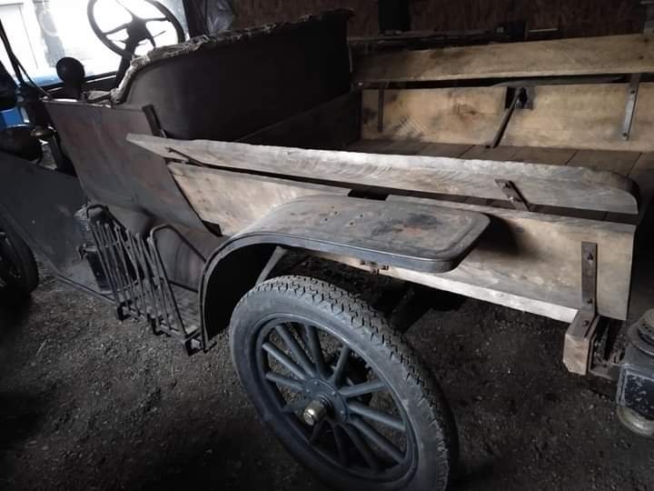

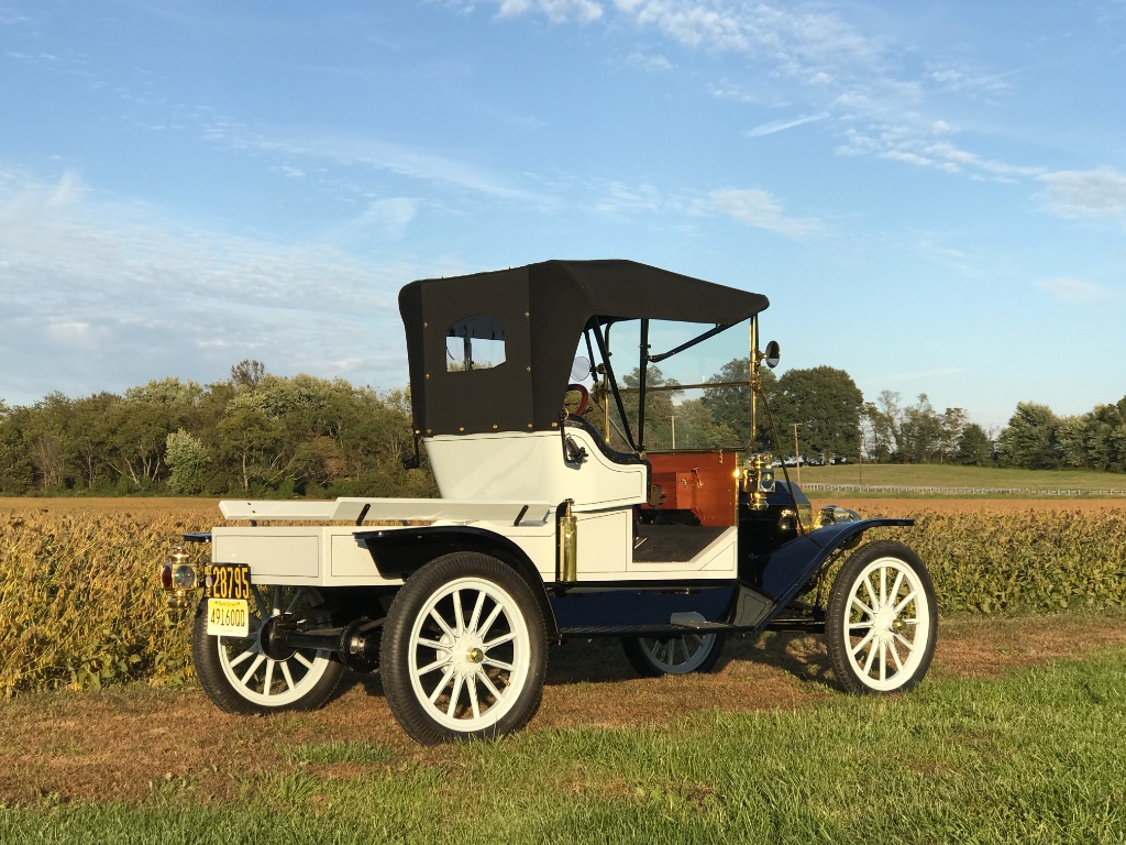

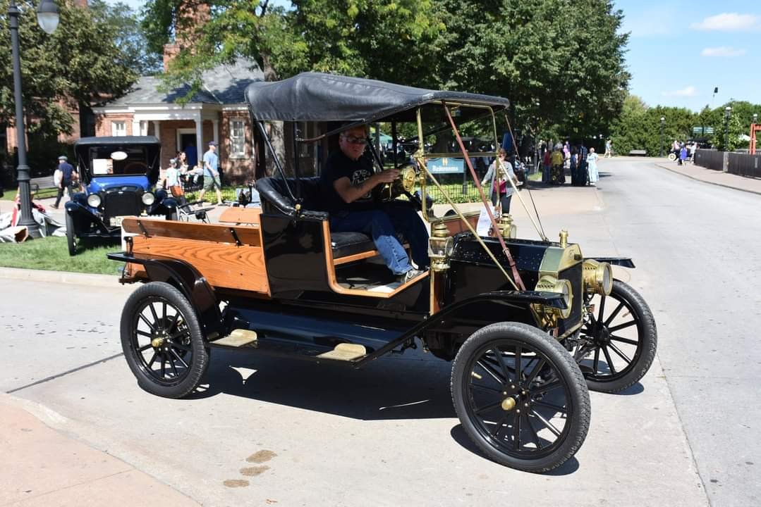

Here are some pictures of our ‘12 Pickup. Not really a torpedo though.

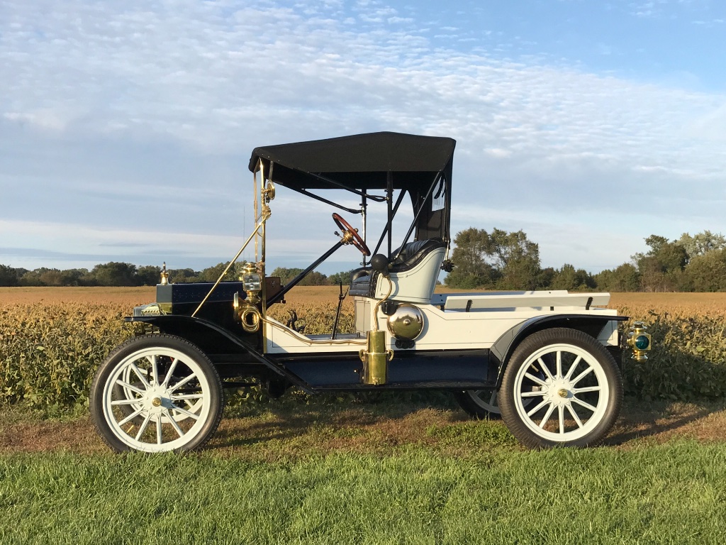

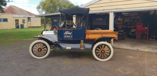

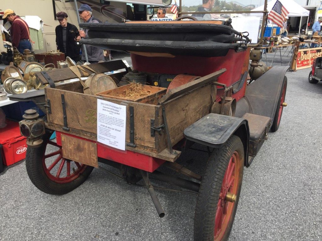

Not a torpedo, but a commercial roadster...
Not a problem, but I would probably shorten the bed some to make it more aesthetically pleasing to the eye, not just throwing a bed on there as an afterthought look.
Yea, I might shorten it an put a brace underneath so it does not crack if someone sits on the end.

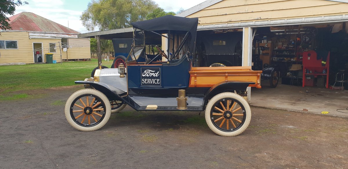

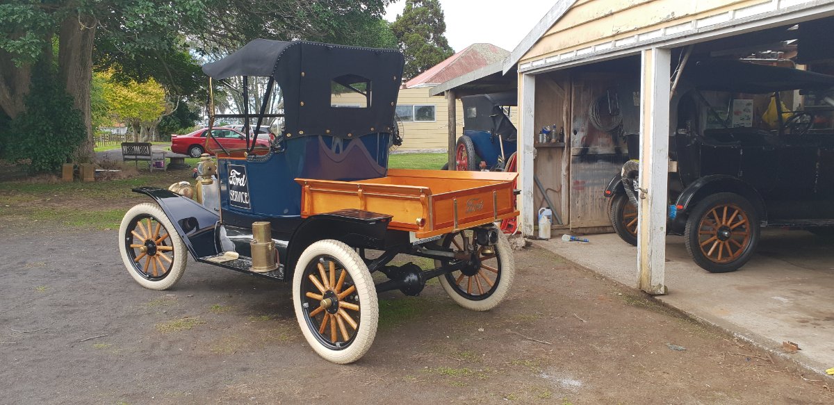

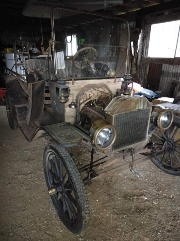

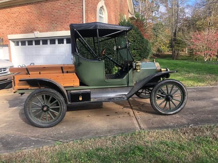

Tray on my 1912 torpedo
Yes i did think longer tray, but i made same length as body, as it looked in perspective, torpedo model, you need to shift petrol tank about 30mm on chassis towards engine to fit under seat. Tray is made of new zealand kauri, and varnished with brass fittings. I took inspiration from this photo.
Chris
Chris

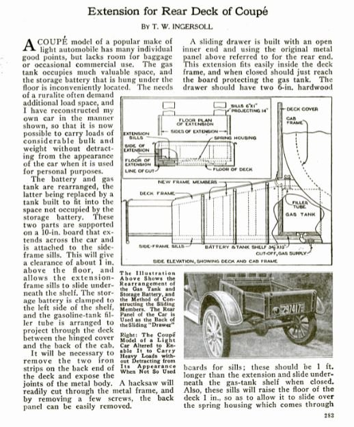

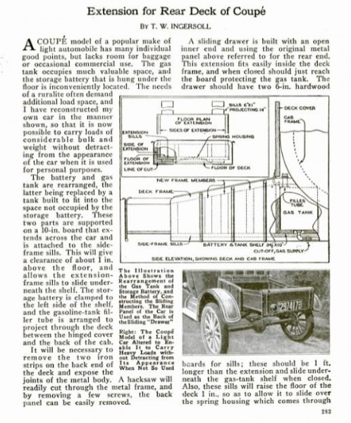

Was done way back in 1921 in Popular Mechanics August page 283
Has measurements and is extendable.
