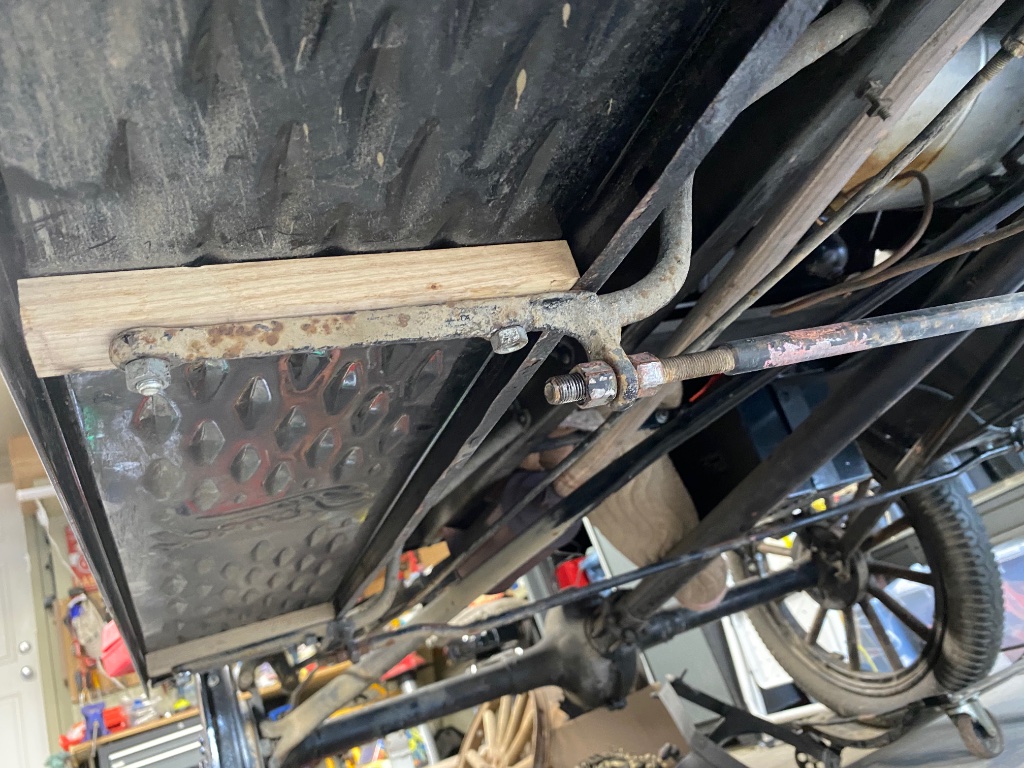

With our Canadian sourced cars it is generally believed that the forged running board supports were last seen on 1921 models. My 1922 low radiator wooded firewall car was sold new in 1922. Unfortunately, the previous owner put a rod through the side of the block, and a car which was known locally from new lost its original engine which was scrapped.

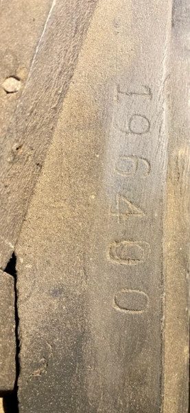

I found this number carved into the wood on the drivers side floor area. Is this a frame/body serial number. ? If so can anyone determine what it means ? Thanks
John
John
- Posts: 4393
Re: Help me date my Canadian Touring Model T
It is probably a body builder's serial number? I don't know enough about the Canadian body supplier companies. In the USA, most of the outside (not Ford owned companies) building bodies for the model T needed to put serial numbers on the bodies to identify and track the bodies for billing and warranty purposes. In the USA, many of those companies also date coded the serial number to help with tracking. In your case, I do not see a date code in there. Whether that is a Canadian difference? Maybe it wasn't necessary with the lower production than USA needed to track? I do not know.
On the USA cars, the body's serial number was strictly for billing and tracking purposes. The number had no real significance beyond that. Whether that would be the same for Canadian production or not, I don't know. But it is another interesting tidbit in the Canadian differences. I hope someone that knows the Canadian cars better than I can help with some clarification.

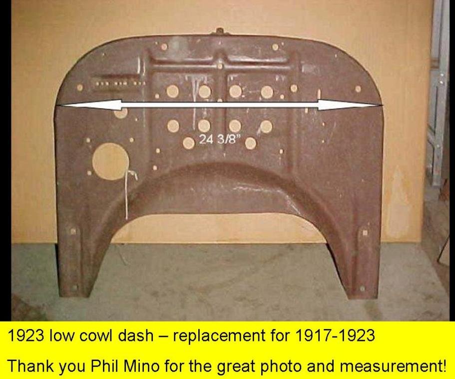

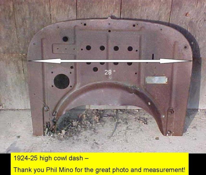

What is the width of your dash / cowl? From the photos you posted I cannot tell what size cowl you have. Below are the measurements on the metal firewalls -- but the 1917-1923 wood firewalls were the same and the 1924-25 should have been metal but someone may have replaced the metal firewall with a wooden one. Probably not -- but for dating the car -- that was a major change.

Thanks for your help Hap. I believe my T is cobbled together from a few years and many parts have been replaced with reproductions so Im trying to nail down exactly what year I should call it.
The windshield I was given is a square 2 piece windshield. The bottom larger one has a handle in the middle so I assume it pushes out. The top one may swivel out as well as it had nickel plated T-knobs on it. They dont fit the aftermarket stanchions I have as there is about a 2 inch gap between the top and bottom pieces. Also, Im not sure if the square windshield or the rounded, fold-down style is the right one for my T. Ill sort it out.
Thanks for the pics on the difference between the 1 and 2-man tops. My car only came with a rusty set of roof irons and a few rotten bows so i wasnt sure which top it was. Thanks to the pics I now understand the difference between the 2 and mine is definitely a 1 man top so that helps greatly.
I will measure the firewall (dash) when i have a chance also. That is a reproduction wood replacement on mine.

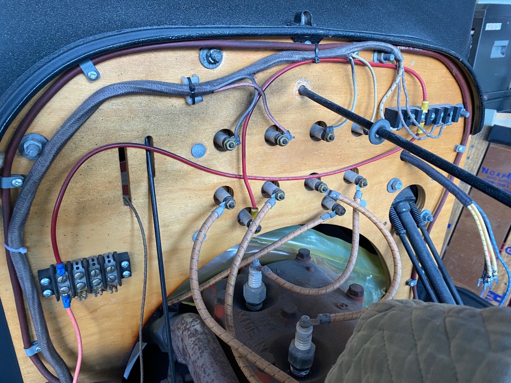

If your car has the coil box with the ignition switch built in that indicates that either the car was a non starter car or when the car was put together the guy used that type of set up because that’s all he had.
A starter car has an instrument panel with the amp meter and ignition switch combo in it mounted on the instrument panel. That was a change in late 1919.
I think that because of the sort of mixed up parts whatever is on the title use that year for your car.
There are more than a few that have been built up with available parts that are Model T parts and will fit but not quite right for year identification.
If it runs and drives good and has a clear title I would enjoy it as it is. You can change the parts for the right ones that are the majority later on as you go if you wish. My opinion of course.

My dash is 24-3/8 wide. Therefore Im guessing its a 1921-22.Also Ive forgotten what year did the Canadian manufacturing change the Touring from the 5 panel rear tub to the 3 panel ?
