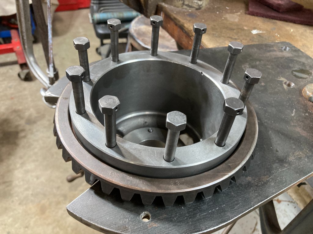

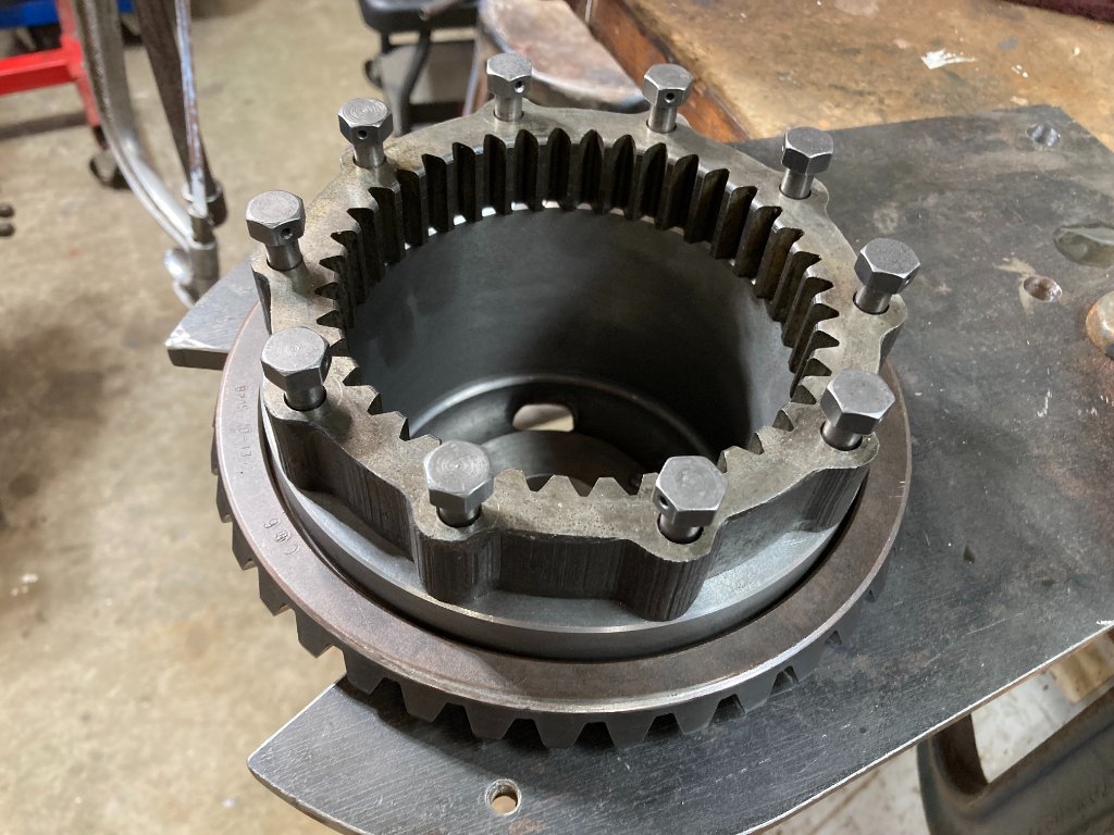

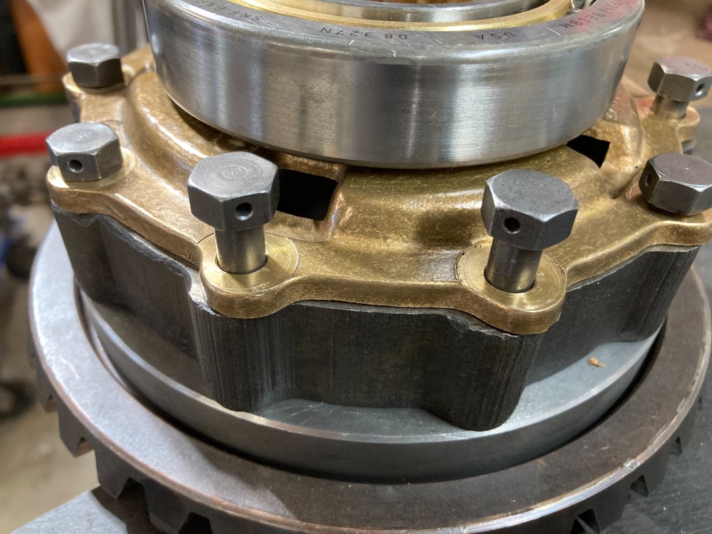

Difficulty getting 30-35 lbs of torque on Ruckstell Ring GearBolts
henryford2
Topic author - Posts: 829
- Joined: Sun Jan 06, 2019 4:14 pm
- First Name: Joseph
- Last Name: Andulics
- * REQUIRED* Type and Year of Model Ts owned: 1926 Fordor, 1926 Truck, 1927 Roadster GOW, RAJO Sprint car
- Location: North Ridgeville, OH
Has anyone else had difficulty with the currently available Ruckstell ring gear bolts in getting the specified 30-35 lbs. of torque and aren't the washers suppose to be hardend as mentioned in the handbook? I have two styles of torque wrenches a beam and clicker ( I use one to check the other) these are not inexpensive Harbor Freight Tools. What am I doing wrong? Suggestions?

Re: Difficulty getting 30-35 lbs of torque on Ruckstell Ring GearBolts
Joe, new ring gear ?
Did you chase the threads in it ?
Threads in the ring gear are fine (hardened so tough to chase). The rear end has already been assembled and clearances set, this happened in the "final" steps of assembly.

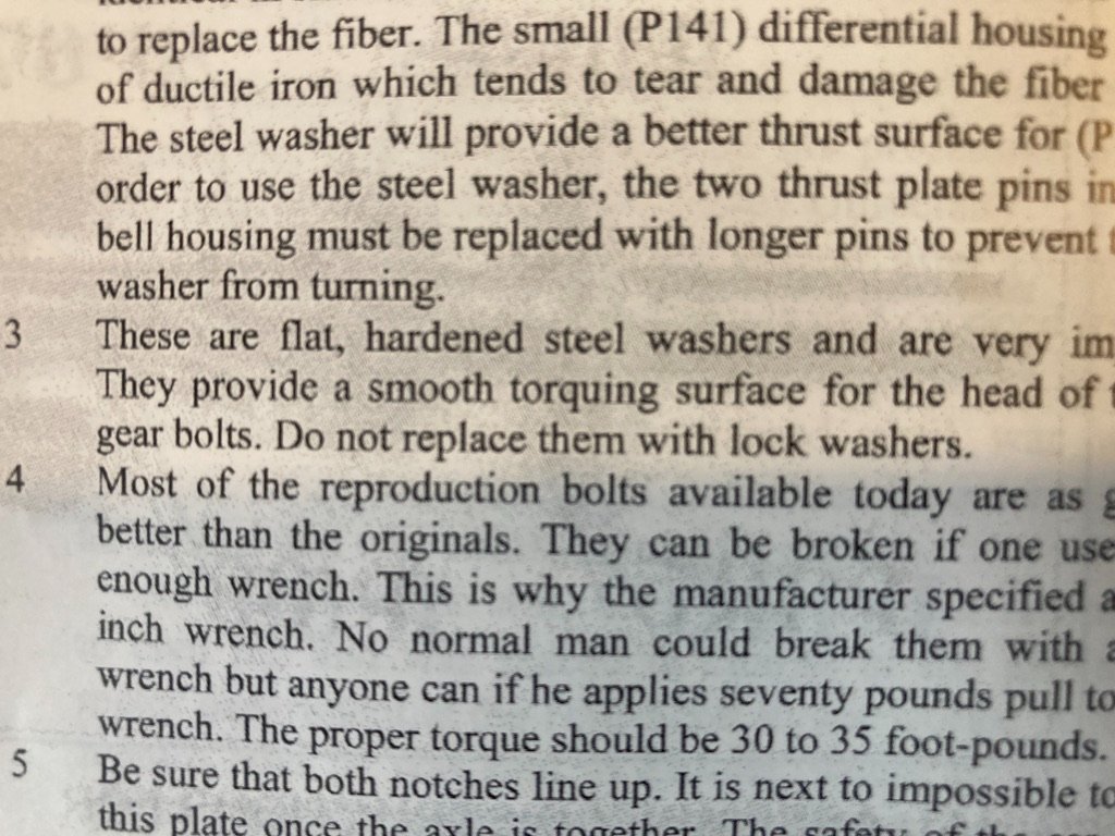

wish i had read this before today http://www.mtfca.com/discus/messages/70 ... 1505355710. Those are grade 8 washers mine are not? Threads were oiled, threads in ring gear are good, I'll follow Dan's advise and shoot for the 20 ft. lbs. of torque

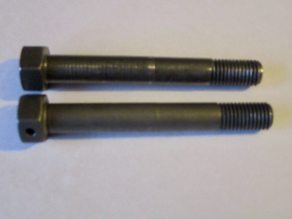

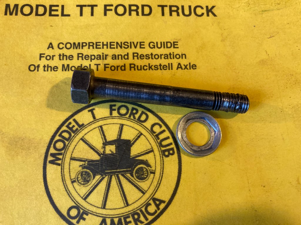

On a Ruckstell axle with mainly new parts from Chaffins several of the threads on the bolts failed at 30 lbs ft. I spoke with Dave and he replaced the bolts with new ones with no problems. He mentioned that the bolts were treated in batches of about 1000 and some don’t make it. Annoying but not much can be done without considerable expense.I guess you pays your money and takes your choice.
So yes they can and do fail.

Regardless of everything above, expecting a 5/16-24 bolt to torque at 30-35 ft-lbs is just plain incorrect in my opinion. I'll assume that Chaffins bolts are made from a proper alloy like 8640 or 4340 and heat treated accordingly, but even ARP 190KSI 5/16-24 bolt recommended torque is 28 ft-lbs and that is using ARP thread lube, and this is for a very high quality fastener.

With my background and experience I should have been skeptical of the 35 lb. ft. of torque on the bolts. This was my first Ruckstell build and I was using the yellow book as the "bible" during the rebuild. I did not intentionally oil the threads, but I didn't ensure that they were dry either. Fortunately I had just started the final torquing of the bolts and the very first one failed trying to achieve the stated torque. What irks me the most was the soft washers that were supplied with the bolts. Why use something other than the same grade washer as the bolt? A trip to the hardware store fixed that. I'll know better in the future!

Mark Chaffin
- Posts: 4849
- Last Name: Chaffin
- Location: Lake Elsinore

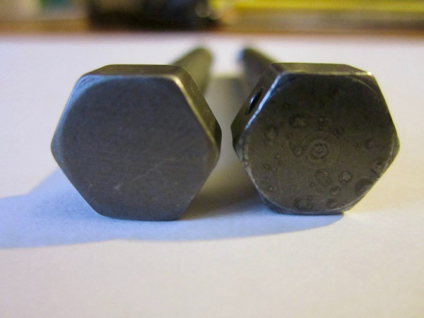

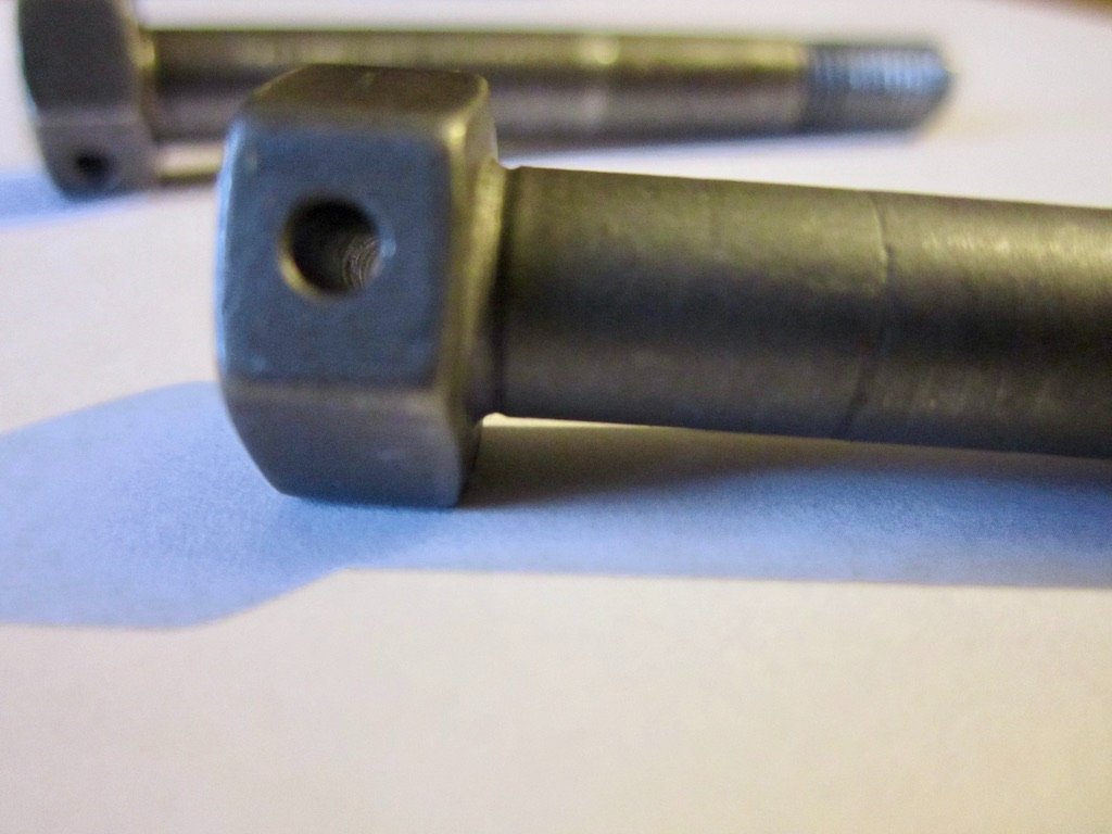

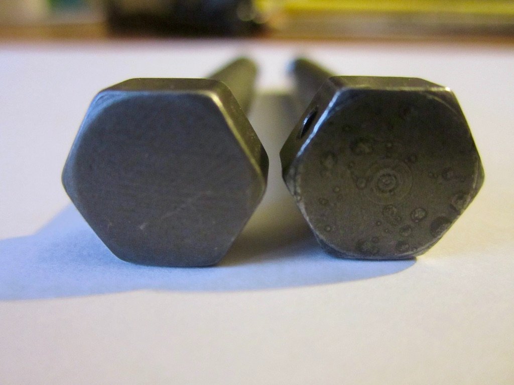

Hi Joe! Sorry to hear you are still having difficulty with your Ruckstell build. I'm must say I am bothered by the picture of the ring gear bolt and washer shown in your post. The bolt appears to have a black oxide finish and the washer is surely not a Grade 8. I'm not sure where you obtained these bolts and washers as they do not appear to be ours. Below is a picture of our P128 bolt and washer set from our most recent (2019) production run as well as the Heat Treat Certification.
Furthermore, the picture of the bolt with the damaged threads appears to have been cause by excessive force and / or an alignment issue with the ring gear and Ruckstell parts when mated together. We have found original Ruckstell part tolerances do vary from part to part and were not held to today's tight tolerances. In contrast, our Ruckstell parts are CNC machined and held to a tight tolerance. When using our Ruckstell parts with original Ruckstell parts, we have heard of customer's experiencing interference issues. However, this is rarely the case. To verify our tolerances were correct, we randomly selected and assembled the parts in question (P159 Differential Bell Housing, P93 Internal Ring Gear, P139 Bronze Thrust Plate and Ring Gear) using our P128 Ring Gear Bolt Set. We did so, without installing the Grade 8 washers to ensure the bolts seated properly without interference from the step on the shank above the threads. We were able to tighten the bolts by hand without any interference.
Lastly, as mentioned by dad in the prior posting, the recommended assembly torque value is 25 lbs. Yes, this is in conflict with the 35 lbs. as indicated in the Ruckstell Manual. Where this prior recommendation came from is a mystery as neither Ford or Ruckstell cite torque values. Hopefully, the Ruckstell Manual can be updated to reflect this change before being printed again in the future.
In closing, I hope this helped answer any questions you and others have regarding the likely cause of the problem and the quality of parts we manufacture. Furthermore, I have directed Dave to send you a P128 Ring Gear Bolt and Washer Set free of charge to help you complete your Ruckstell build.

Based upon the striation marks visible on the P93, it is the likely culprit. Since is appears you are having interference with only two of the ten bolts, I would relieve those two holes in the P93 by drilling them out with a slightly larger drill to provide the clearance you need. Be sure to mark the orientation of the of the parts in relation to one another for reassembly. Hope this helps. The P128 Bolt and Washer set just went out USPO Priority. You should receive them soon.

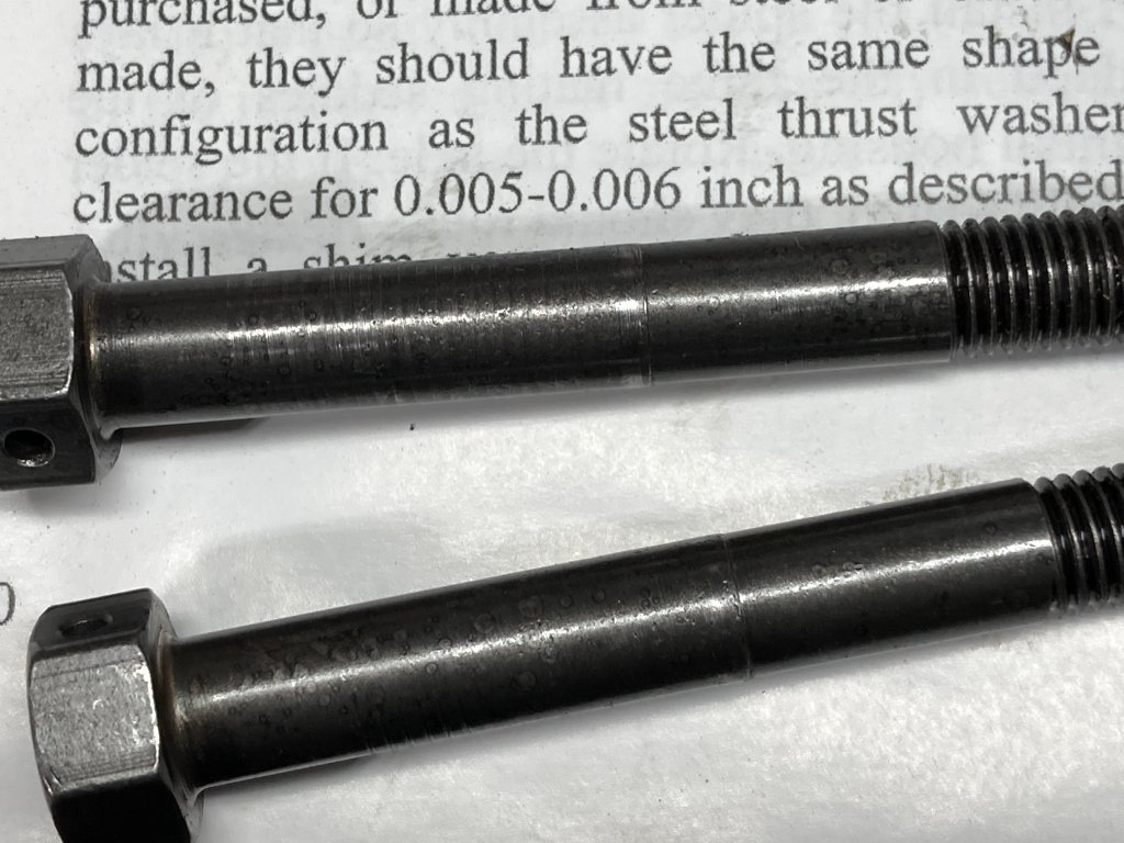

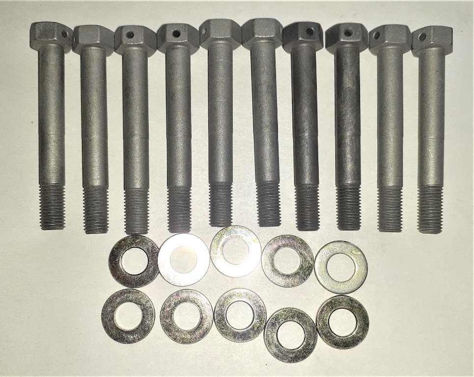

Got the replacement bolts today. Thank you again. In comparing the old to the new, they do have a different finish and machining marks, so either a different vendor or different batch? The one thing that drew my attention to the new bolts is that the shank has an "undercut" at the start of the fillet under the head. In my experience if the bolt is in a relatively high stress condition I would have avoided the undercut and had the fillet tangent to the shank (just my humble opinion). Lastly if I continue to encounter issues bolting the assembly together can I safely open up the holes in the P-159 to .3230 (letter drill P) which is considered a "close fit" hole clearance for a 5/16 bolt? I believe they may have been originally drilled with a "O" size drill? Drilling the P-93 is not an option, it is hardened. Thanks again for the help!
