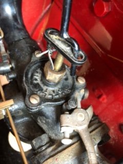

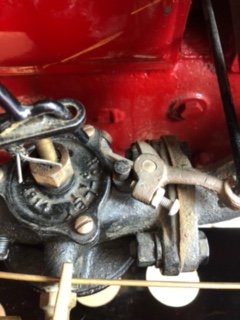

Holley Mod G on TT
Holley Mod G on TT
Holley Mod G on TT
Holley Mod G on TT
is this a Mod "g" Holley Carb? and is it correct to my vehicle?

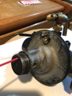

Holley Mod G disassembled weep hole bottom of bowl
Red pointe shows the "weep hole" I' talking about.

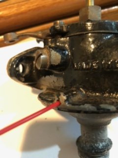

Holley Mod G disassembled weep hole top of bowl
While disassembling Carb, notice fuel coming out of this "weep hole" (red pointer). What is the function of this?

being a gravity-fed system, nearly all "T" carbs will eventually overfill and then come out either an overflow or out the throat...ALL "T" carbs should be outfitted with an external "off" valve...OK, lecture over...
that hole is the overflow. Under the venturi, there is a small tube that sits up proud of the jet inside the carb. Your fuel level is reaching that height and then dripping out. That may be because either the float level is set too high, or the float valve is simply allowing some weeping past it and once the bowl fills up, it then slowly leaks out of the overflow. If the attached photos are of YOUR carb, you have a Grose valve for a float valve. UGH. They are known to alternately leak or quit flowing, and somehow manage to do exactly the opposite to what you want or need at the time. In the near future you will be doing yourself a service by replacing it with a more conventional valve (preferably one with a Viton rubber tip). Invest in the MTFCA Carburetor Manual and thank me for the advice later!
Your "big bang" was not associated with this and if the truck ran before and not now, it is unlikely the carb (though it DOES need attending to).

Dave, from the pictures, your carb is a Holley G (rhymes with "golly gee !")
The MTFCA carburetor manual has good instructions on its care and feeding, and if you can search this forum, there have been several posts discussing this carb recently. I believe it is "correct" for your TT from the standpoint of authenticity, but barring that, most agree it is a fine carb to run on a T. Good luck, please let us know how you make out !
