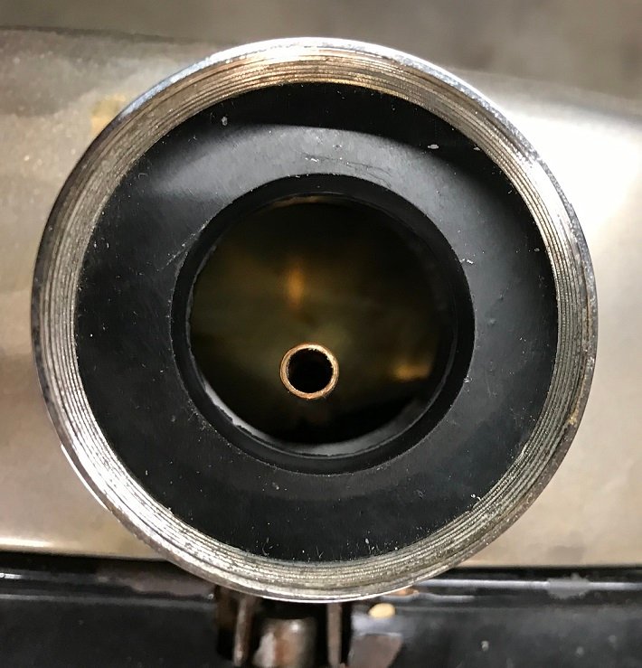

Question About Radiator Cap
Should there be a rubber gasket under the radiator cap?

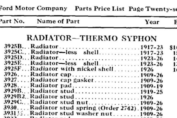

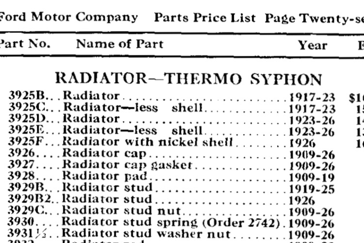

- Posts: 4082
Re: Question About Radiator Cap
Yes
Ford part #3927
Ford part #3927

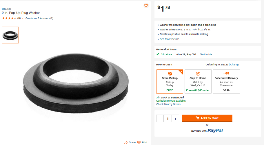

Or stop at your local hardware store, even the big box store, and get a drain gasket.

- Posts: 6579
Old thread suggest using a popup drain gasket as it is the same as sold by vendors and available in most hardware & ome Improvement stores
http://www.mtfca.com/discus/messages/59 ... 1460135057
