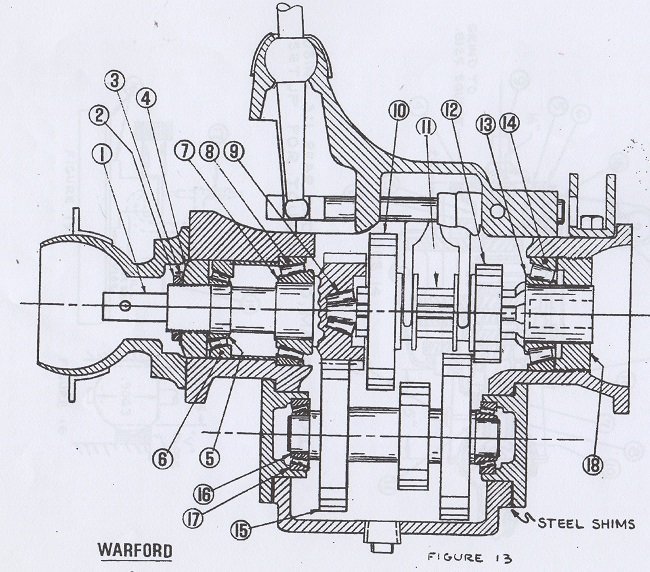

Been fighting a leaking Warford trans that leaks out the the rear more than the owner would like. This can be resolved in a Muncie by using sealed ball bearings. Has anyone tried using sealed ball bearings in a Warford instead of taperd roller bearings?

I think because of why the tapered bearings were used and setup, you would have to use a thrust type bearing, like the one in the Ruckstell. Find the OD, ID and width (more than likely in millimeters) and do some checking. What weight/type lube is being used? Is the leak for sure coming from the rear bearing or is it the shift rails or is just the grease out of the U-joint housing? I would have to check, but maybe a seal could be added to part 18. Or this is something that they would just have to live with.
