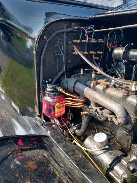

Marvel Mystery Oil
- Posts: 6538
Re: Diesel fuel
With all the discussion about modern gas and advocates for higher octane, why choose a method to lower the fuels octane rating.
Perhaps as an experiment to see what it was like back then to drive a Model T with the low grade fuel of the era. But we need to remember that back then kerosene was more accessible than gasoline and was a fuel option http://www.mtfca.com/discus/messages/41 ... 1404251165

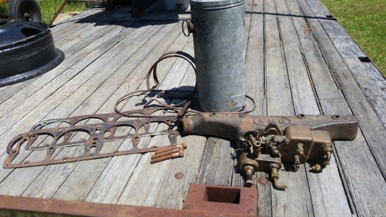

Nick Stanley on Tuesday, June 24, 2014 - 10:24 pm:
This past year I acquired a kerosene conversion for a Ford from California. It is NOS near as I can tell, and I plan on putting it on my 1918 TT to evaluate its performance.
The conversion was made by the Kerosene Motor Co., of Peoria, Ill., and is called the KMC Transformer. It was apparently developed, and patented, by George McFarland. Stamped on the back of the manifold is "PAT 12-11-17". This date corresponds to US patent no. 1249647. The patent can be found at http://www.google.com/patents/US1249647 .
The kit as I received it, included a KMC manifold, dual fuel carburetor, gasoline starting tank, a bit of 1/4" copper line, an old Victor head gasket, and a head shim of .112" thick carbon steel. This shim was presumably included to decrease the compression ratio.

Kerosene has most of the disadvantages of diesel. People used to try to use it for motor fuel because it was plentiful and cheap. Some success was had using it in farm tractors and stationary applications. It just isn't suited for most road car service. A tractor or stationary engine that routinely ran for long periods under load once started would be the best candidate for kerosene operation. They usually started on gasoline. Even the best systems required proper handling by the operator and often had problems with oil dilution, rapid ring and upper cylinder wear, carbon deposition, and detonation as well as cold starting and cold weather issues. Water injection was used in some instances to reduce detonation and carbon deposits. A farmer or mechanic who understood how to use one of the kerosene conversion setups on a Ford T and understood the drawbacks to using it could probably get good results, within limits. Most people would not, and short trip passenger car service would be the least practical way to use a kersosene setup.

Marvel Mystery Oil probably deserves to be the laughingstock of this forum from rather fantastic claims made years ago in their advertising. Nevertheless, it is a useful light oil as John points out, and it smells good !!.
"Get a horse !"
- Posts: 8363
Re: Diesel fuel
It looks good and smells pretty... and it does have practical uses. In my long expericence running junk machinery, there is no miracle in a bottle, but MMO and STP do have their uses, along with B-12 Chemtool and similar products. Marvel Mystery Oil used to be quite useful back when only straight grade, non-detergent motor oils of uncertain quality were available. Quality modern motor oils already have the properties that MMO, used correctly, could add to plain oil. Upper cylinder lubrication seems to be well taken care of in most engines built in the last 70 years or so. That was not always the case, especially under adverse conditions.
- Posts: 4618
Re: Diesel fuel
I use MMO in my 54 Ford NAA tractor to keep the valves from sticking and it does work for me. I don’t get paranoid about the name and the idea that’s it’s not any good like some folks do.
If it works it works. Have fun.

Looks snazzy too!Rich Bingham wrote: ↑Fri Oct 08, 2021 12:18 pmMarvel Mystery Oil probably deserves to be the laughingstock of this forum from rather fantastic claims made years ago in their advertising. Nevertheless, it is a useful light oil as John points out, and it smells good !!.![]()

An inverse oiler might benefit a Fordson tractor that pulled a plow all day, or any engine running hard on kerosene fuel. An antique passenger car in normal service usually gets plenty of oil to the upper cylinder area, if not too much.
