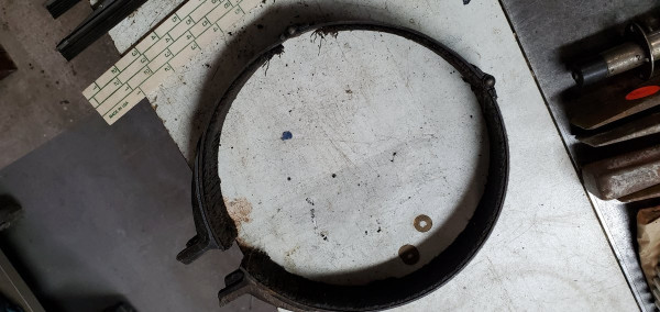

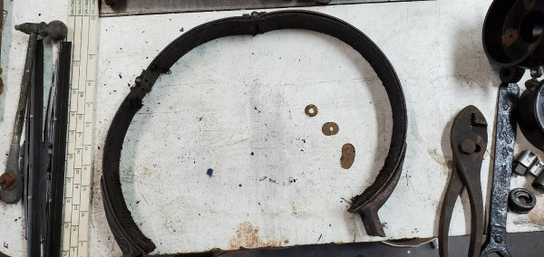

Anyone have any experience with these? Pro con love them or hate them? Advice on how to properly line them or just hang on the wall?

I like the idea, but any wear at the hinge points would probably cause trouble. Hinged bands could be easier to install and could give better engagement, but everything would have to be in good condition and would have to stay that way in service. That seems like a tall order to me. Standard bands that are properly lined and installed work pretty good, and have fewer potential failure points.

I have a set of three hinged bands. They are wall hangers for display only. I do not have experience using them

I'd think the Herm method would allow the band to clamp more evenly on the drum with a little less pedal pressure. Oiling and heat dissipation would likely be improved. Installation of the band assembly might be a little easier, too. Any tendency of the lining to bunch or wrinkle would probably be reduced.

I have a set of hinged bands that was made by Raybestos. They are well made. I have them in my 26 Coupe that I drive about 1000+ miles per year. They have been in the car at least 10 years. No problems with them and I haven't had to change the band linings yet.
