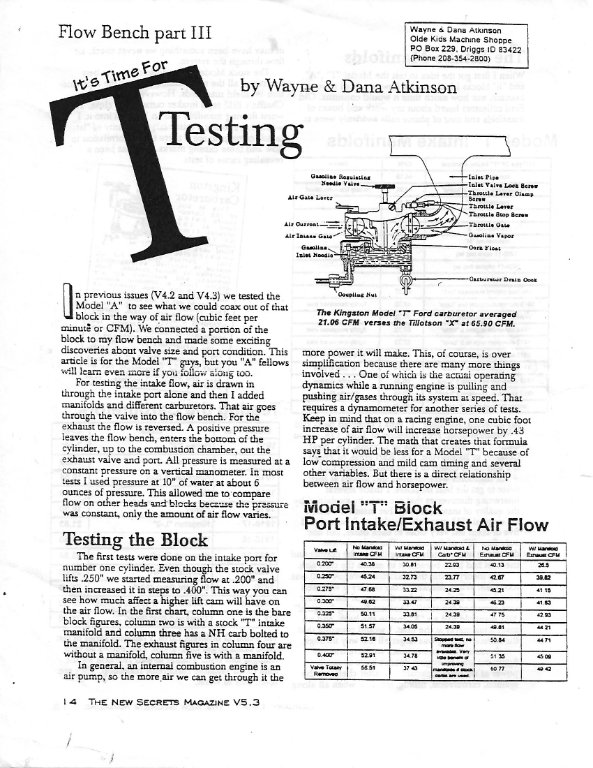

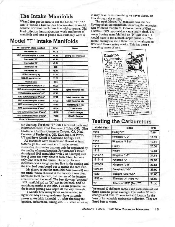

Here's some carburetor and manifold flow info. Hopefully we're not running afoul of copyright law.
