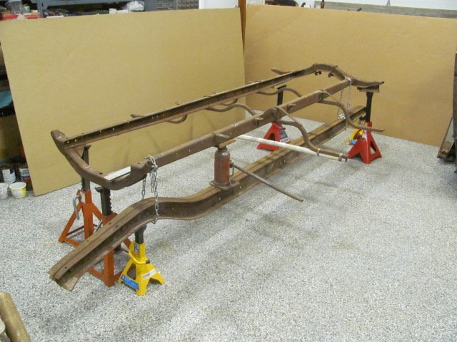

I assume that in these pics, you are bringing the frame back to square and flat status? Was any particular area worse than another as far as how it had bent through use?

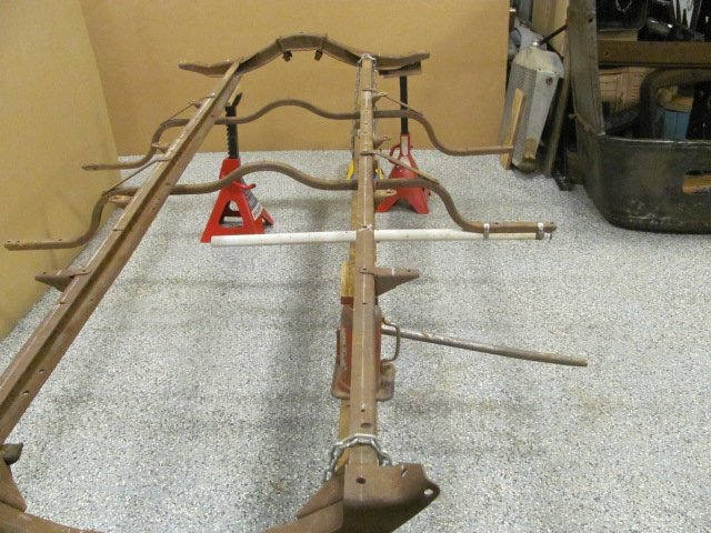

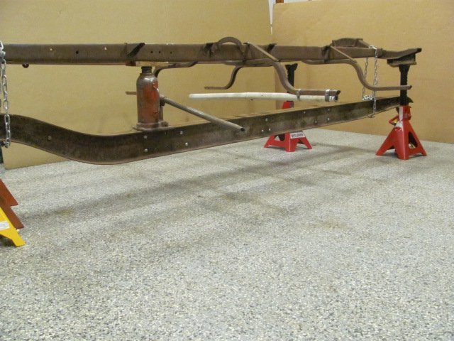

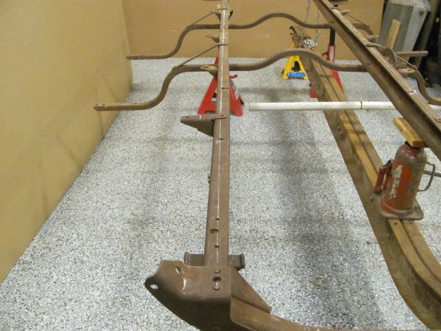

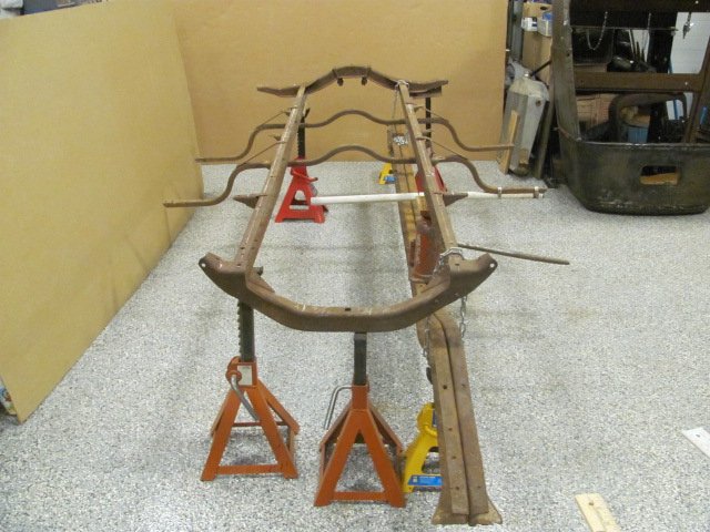

Many emailed me regards to how I straightened the frame on my T with the body in place a year back. As you can see, it is no different with the body on than with out the body. I merely used a 4” x 6” x 12’ wood beam instead of the metal beam shown here. Look at how and where the beam is strapped on to the frame and the Jack is slid to where the worst part of the frame happens to be. I placed a 2” x 4” between the Jack and the frame to keep the Jack from slipping off the metal and having a missile coming at me. Great example of how to straighten the frame. Just my .02 cents. Frank
