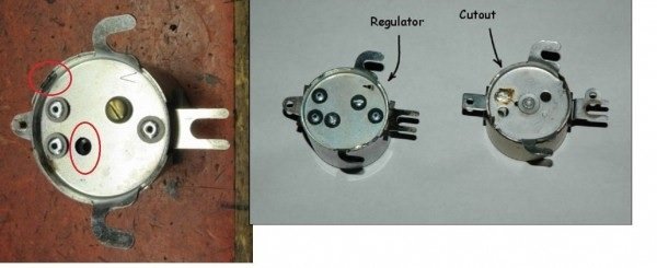

The T (and A) generators are current devices. They'll happily charge a 12V battery without need for conversion.
If your friend's unit has a regulator then it's likely that would need to be changed for 12V operation, if it's a cutout then there is no need.

You may want to make an inquiry on one of the Michigan Universities having an Electrical Engineering department.Making it 12 volts shouldn't be much of a challenge as there are 12 volt ones & maybe some are still available (Lang's lists them and doesn't indicate out-of-stock) Whomever works on it needs to know that a Model T generator uses a 3rd brush, not a conventional generator.
- Attachments
- reg vs cutout.jpg (28.14 KiB) Viewed 1289 times
