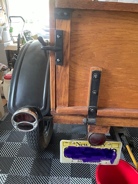

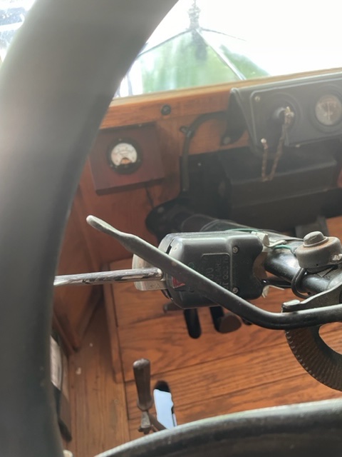

The switch itself doesn't have to be expensive to be any good. A simple on-off-on switch will do. My recent winter project was adding tail/brake lights and turn signals to my 1915 runabout. This being a non-starter car, I went with a 12 volt setup powered by a mower battery in the trunk. Rather than buying a whole ready-made system, I bought the components from local stores and various websites and put it all together the way I wanted it. I decided on 12 volts because those are the LED's most available. I used tail/brake lights and rear turn signals picked up at Hershey and put 1156 sockets in the side lamps for front turn signals. The control panel has bright indicator lights so I won't be the old guy driving down the street with his signals flashing.
https://www.youtube.com/watch?v=lH85w4Yqhi4
Emergency! Emergency!

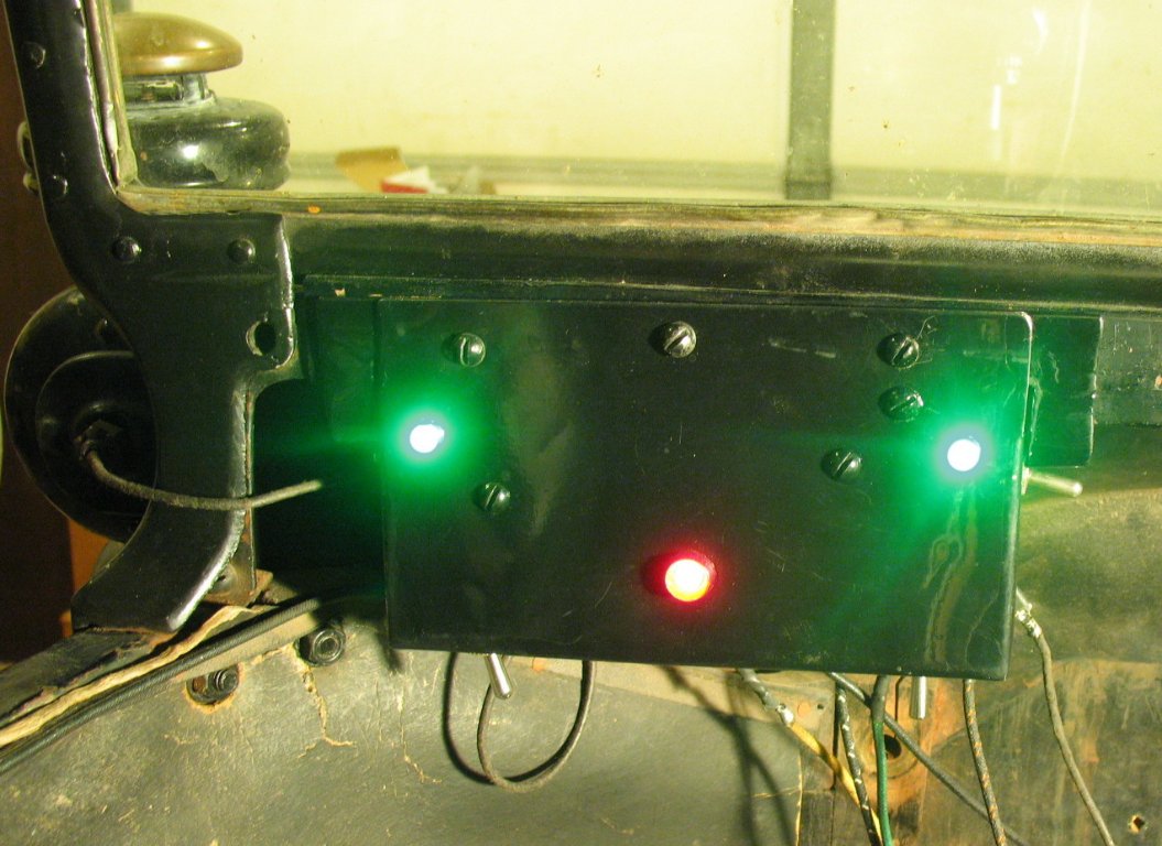

I built my own switch around an off-the-shelf 3-position
toggle switch, fabricating a sized-down/lookalike version
of the spark and throttle levers, so as to not look out of
place on a 100-year-old vehicle. I ordered a 6v motorcycle
blinker unit for that function, and built a "motherboard" to
make all connections from off-the-shelf motherboard stock.
Following Steve's logic of not wanting to be driving around
with the blinkers constantly going, I fabricated a tiny light
board that sticks up from the base of the dashboard. Both
sides are routed through colored diodes and blink with the
actual indicator lamps.

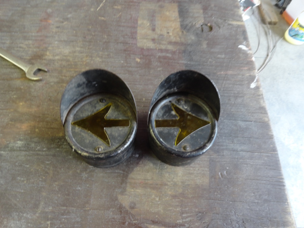

For indicator lamps, I hunted down some early indicator
lamps with arrows for the rear. I was never happy with anything
for the front, and decided to simply use some of the same diodes
as used inside the cab, as they are super tiny, making them invisible
until lighted, and they are super bright.
I also wired in a 20's vintage "STOP" light for the center to
light up when the brakes are applied.
What isn't old is invisible/looks like it should be there, and
what is obvious looks like it was put there by the original
owner.

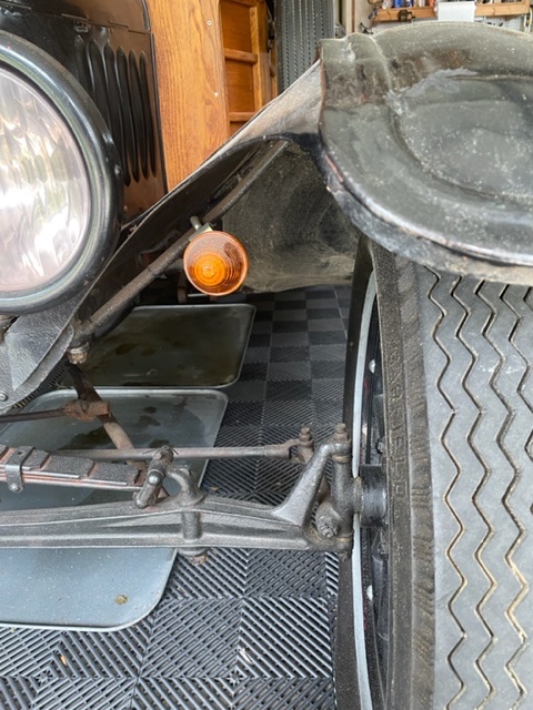

You left out the one with the arthri
tic hand for tailgates. photos of my 26 touring with dual face red amber harbor freight lights on a special bracket made by Bob Doris that attaches to the top saddle tie down posts no modifications and quick removal for car shows one Allen head screw and a quick disconnect electrical connector. I use a existing hole in the dash for a dpdt switch with the electronic flasher and buzzer behind the dash. You can use a dual color red/green led for a visual indicator one led. one small hole. two colors.

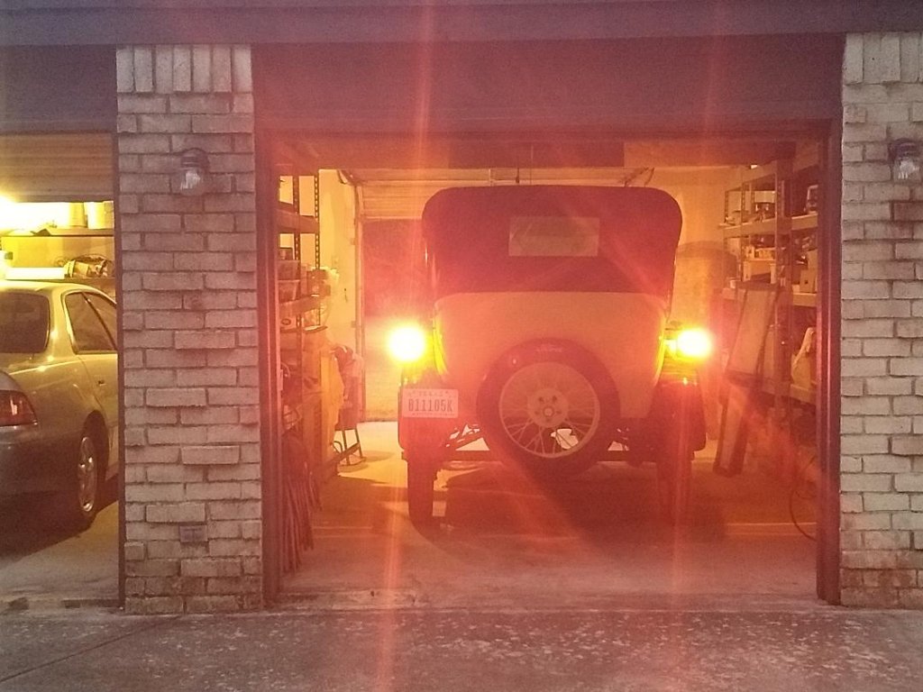

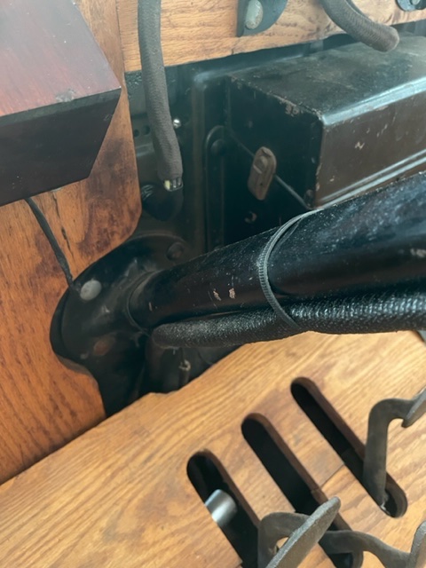

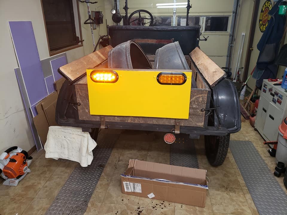

I think the phrase "Best Turn Signal" is maybe not a one size fits all statement. For various style T bodies, there are different opportunities to have a 'custom' approach to fit one's needs using simple, off the shelf (Amazon) parts.
Like Steve, I also sought to develop a turn signal solution for my roadster pickup this winter. I am an architect by trade, and so approached this as a fun design problem to solve. I had several goals that I wanted these signals to achieve.
1) Easily removable. I did not want them to be on the car permanently and affect the well worn aesthetic of my truck. When I get to a show, I wanted to be able to remove them in a few minutes so I could stow the signals away either in the bed or under the truck.
2) I wanted the signals to be large, in your face and highly visible. If the design achieved goal #1, then I was willing for the signals to be unsightly (from a historical vehicle perspective) when being used and installed.
3) Leveraging low-voltage LED technology, I wanted the signal power source to be independent of my T's electrical system, last a long time, and be easily rechargeable.
4) I wanted the actuation switch to be small, robust, and out of the way of the other Model T operating controls since I am a new T driver, and still need practice in operating a T.
5) I have limited electrical and wiring skills so I needed the circuit to be simple, to the point, and something I could fabricate.
6) My labor is free, but the component parts needed to be cost effective. I have a young family and can't afford to spend hundred of dollars at a shot on a 'hobby' vehicle.
Here is what I developed. Here is a video explaining the system: https://youtu.be/tshXIqrg8IA
Is it the BEST SYSTEM AVAILABLE? No. Is it the BEST SYSTEM FOR ME? Yes! I'm proud of it, but it is a prototype and I anticipate making some refinements over the driving season. The large area of Yellow on the back board is going to get a large Flat black "SLOW" painted on it.

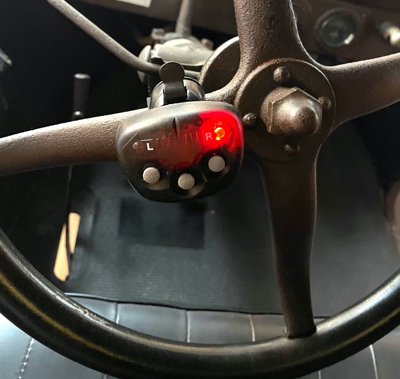

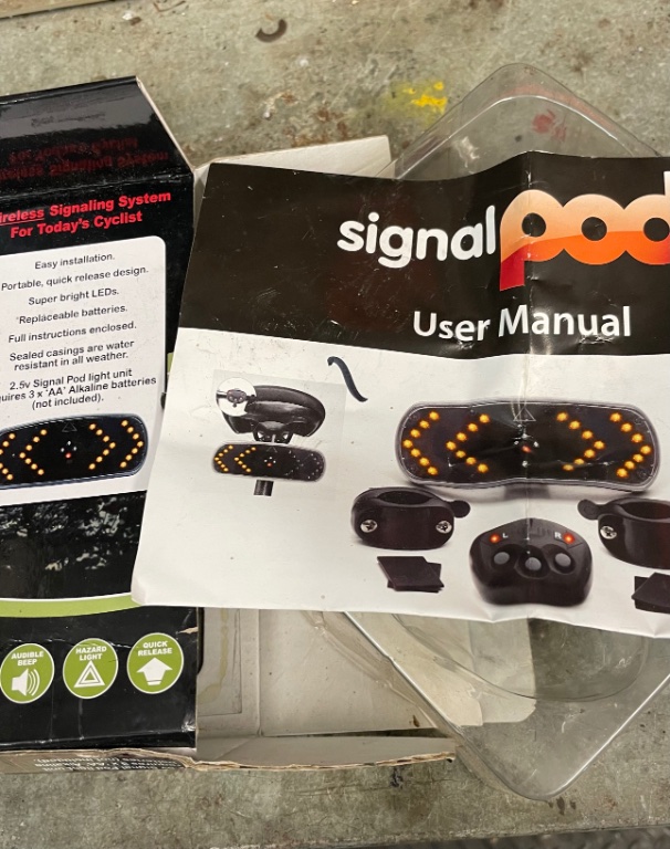

This is what I bought…
https://www.signaldynamics.com/01007
designed for motorcycles that had few/no signals and no dashboard for mounting. integrates with brakes, adds emergency mode, is self-cancelling in use. compatible with LED or incandescent. very inconspicuous installation in cockpit using small momentary-on switches and small indicator lights.
It checked all my boxes…
Keep crankin’
Eric

My 1917 shooting brake has no dashboard to hide any wiring or to mount a switch of any kind. I used an extra throttle rod mounted on top of the column to turn a switch mounted at the base of the column on the firewall. The wiring is all under the hood, out of sight. The front indicators are on brackets mounted on the headlight stalks and the rears are recessed in the shaped outside end rear cross member on the body.

Maybe no best, but easy. China made wireless unit. Mount for bike handle fits spider. Rear lamp offers turn and hazard.
Since most rear ends happen with accidents, having a rear signal is nice, in addition to hand signals too! If your state allows only rear signals, some require front too....but in FL none are required, but nice to have for those who think hand signals are just waving of the arm!!! :lol:
