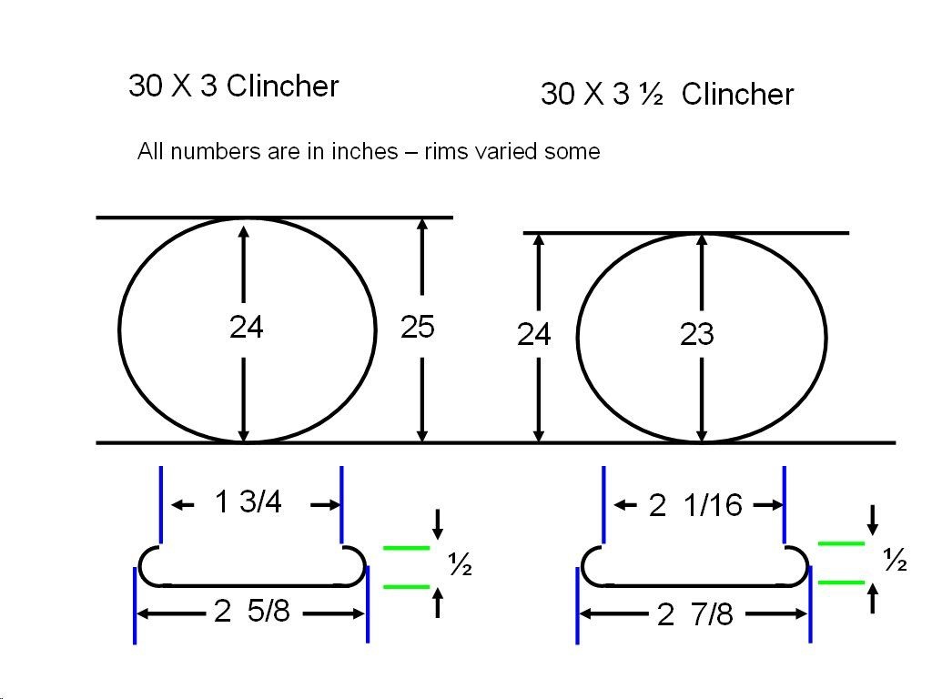

Here is a chart with the differences of the clincher rim sizes for those tires.

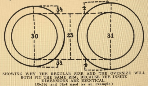

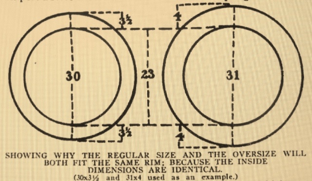

Today we have 'oversize' 31"x4" tires, from all the new clincher tire companies, they are really 31" in outer diameter, unlike the true 30 x 3 1/2 of early days.
