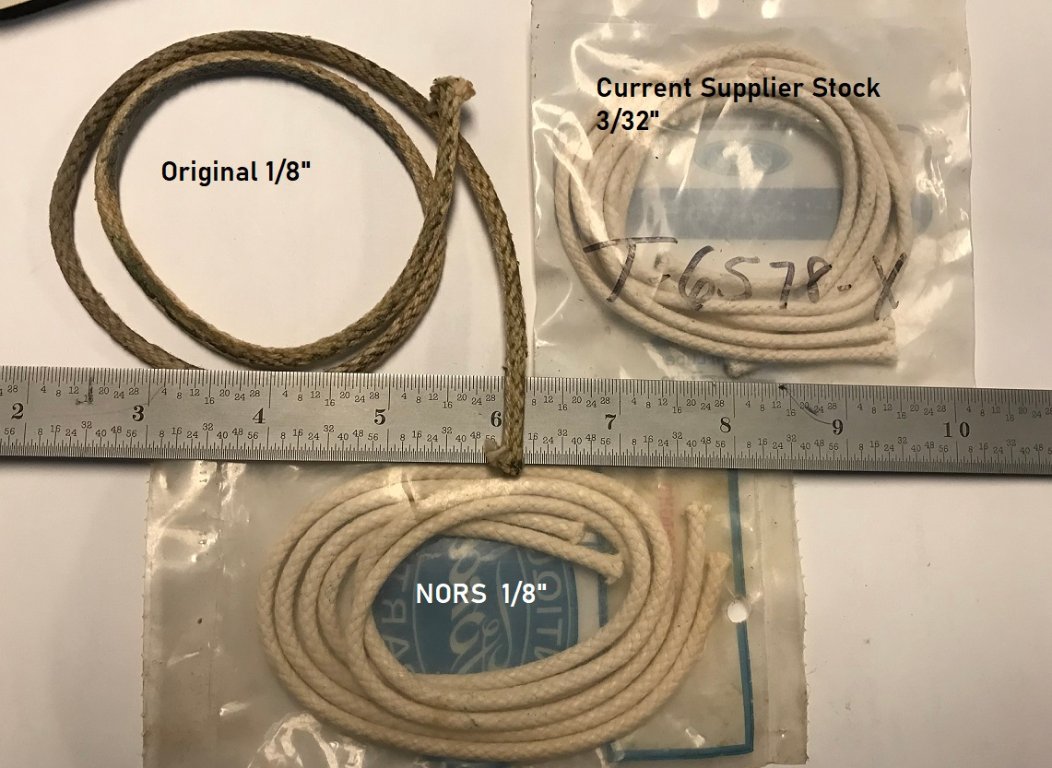

When I originally restored my ‘26 coupe in 1970-72, I had an old man helping me. Mr. Moore had worked for the Ford Motor Company in the 1920’s and was also a Model T mechanic. As a 16 year old kid, I relied heavily on his advice and he showed me how they installed the 1/8” cotton cord gaskets in the headlights in the day. The rope gaskets were cut so that the ends did not touch, but left a gap. Applying some gasket sealant to the cord, he positioned the cord in the reflector groove so that the gap between the rope ends was positioned at the bottom. This was in case water got into the head light, it could drain out. The headlight drawings in the resource section of the forum show the gaskets as solid pieces (with no gap), but the original Model T gaskets were 1/8” cotton cord and were sold as such. That is why the groove in the reflector is rounded. Jim Patrick

As Jim pointed out. Original gasket material was cotton and 1/8". NORS, old repro, was the same (not sure of fiber). Current supplier a bit thinner. All have the same weave appearance. Also an important point Jim made is to leave a small gap at the bottom for condesation and possible water leak to escape.
