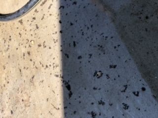

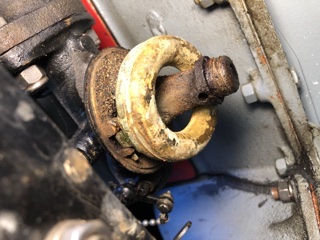

Looks as if a previous owner tried to coat this tank. No wonder no gasoline flows. I have only been successful sloshing and dumping the first 1/3rd. of the tank before the first baffle. Sheets of coating and about 1/4 cup of rust. Any words of advice? Will do this over and over endlessly until nothing else comes out but it looks fruitless at this point…..😊

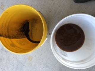

Thanks for the tip. Does the lacquer thinner loosen the old coating or melt it? I am currently letting a water hose run into the top, shaking in all directions, then setting the tank on two 5 gallon buckets and as the water pours out the 1/2” outlet using a piece of wire shaped like a letter “L” to grab large pieces of the coating. It’s like pulling pieces of wet sandpaper through the hole.
Did this for two hours and nothing comes out now so I will try the thinner next. I am getting old. Shaking the tank over and over is a pain. It’s going to be a Tylenol fest tonight!😊

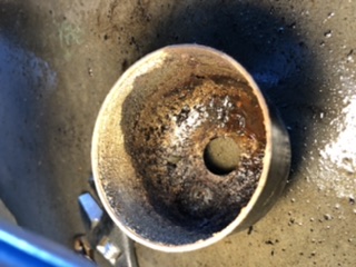

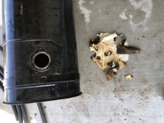

Here is the final piece of tank liner pulled out with my super long pliers from the side with the filler hole. As you can see the large pieces come out and feel like wet sand paper.
Problem is with the baffle at the 1/3rd. mark Looking into the main part of the tank can only be accomplished through the tiny 1/2” exit hole and even with a pencil flashlight impossible to view adequately.
Rest of the week is taken up by family health problems so I will continue cleaning in 3-4 days. Thanks for all the advice. Hard to believe this T ran at all. Look at the rust found in the carburetor bowl etc.!
