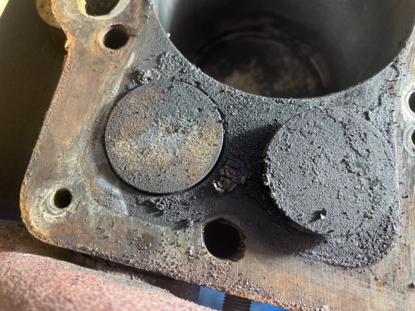

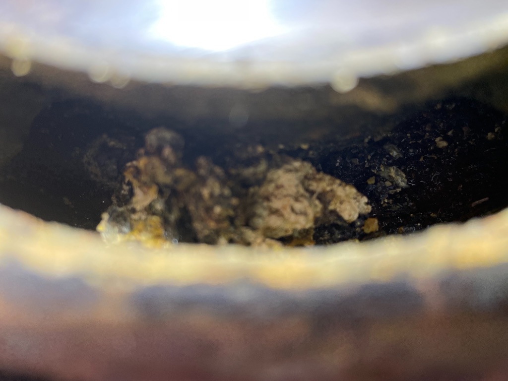

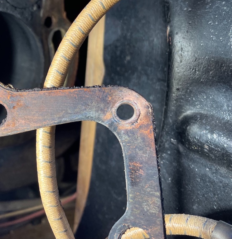

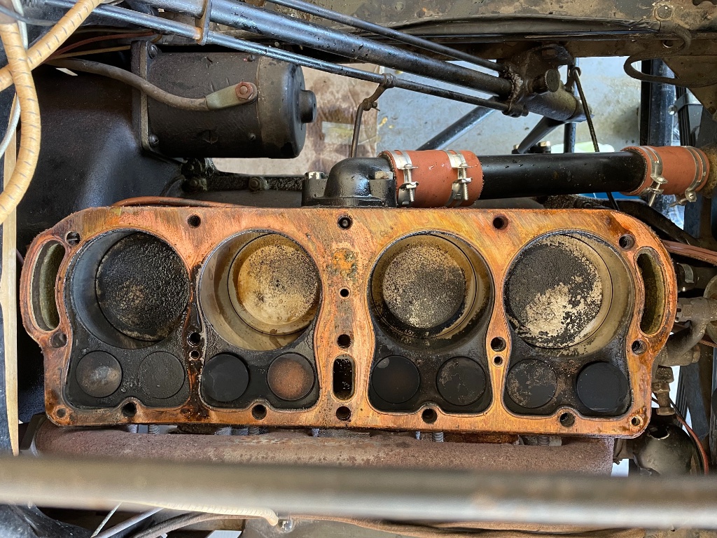

I pulled the plugs and borescoped the cylinders and all looked fairly normal except that #4 seemed oily and it’s piston had more carbon on it than the others (which explains why that plug fouled last week).
I called a friend over who just finished restoring a speedster, and he agreed that it was steam, not smoke. We drove it about a mile and a half then immediately pulled the plugs and got a small amount of steam out of #4. We pulled the head and my friend noted that the head bolts didn’t feel like they had been torqued properly.
There was oil collected on the wall between #3 and #4, but no obvious defect in the gasket. Another friend (not a Model T guy) happened by and noticed a slight bluish white stain on top of the block at the extreme rear corner of the block on the manifold side, near the 1/4” hole into the water jacket. A close look at the gasket and head in location also show what might have been a leak.
It looks like the steam issue might be resolved with a new head gasket, but I’m wondering if the oil issue with #4 also needs to be dealt with, maybe a ring job on that cylinder?
Also, there’s a lot of loose scale in the water jacket forward of #1 that needs to be cleaned out.

I believe you've found your leak. The oily condition of # 4 may be due to rings having stuck due to coolant leakage into the cylinder. That cylinder may have sat wet during storage periods and developed enough corrosion to interfere with the rings. Running the engine would quickly sweep any light rust from the cylinder wall, but rust and aluminum corrosion residue would likely remain around, behind, and between the rings. I'd remove that piston assembly and give it a good looking over and also clean up that bore and look carefully for any damage or evidence of cracking. From here, I suspect you have a head gasket problem with perhaps some secondary damage to the piston/ring assembly in that cylinder. The uneven head bolt torque points to a simple gasket failure, but check everything, including the gasket surfaces and the bolt holes, bolts, etc.

Be sure to check the length of the bolts by putting the head on without a gasket and see if they can be turned down all the way to the head. If they bottom out before they hit the head, you either need to clean the block threads all the way to the bottom with a bottoming tap, and also might need to grind a bit off the bolts to shorten them.
That small hole in the block is called a steam vent. It is common to have a leak there. I have a car in which the entire engine was rebuilt and the top of the block was surfaced, however I did not have the head surfaced. I took it on a tour and it leaked in that place. I didn't even know it was leaking because it was against the firewall and covered by the manifold. I pulled the head and had it re-sirfaced and new gasket. No more leak. Yours might be ok if you use some heat resistant sealer in that corner above and below the gasket.

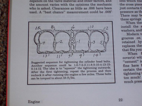

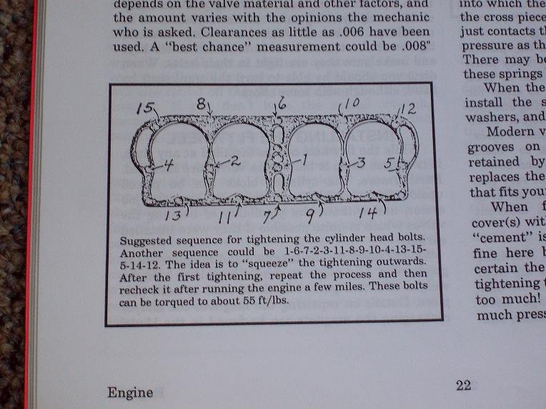

When you have the head off you will need to torque the head bolts in the proper seqence as per the Model T bible and then after running the engine and getting it warm you need to shut it down and torque the head bolts again.

Thank you Dennis, the Model T “bible” was one of the first purchases I made after acquiring my Express Wagon.perry kete wrote: ↑Thu Sep 30, 2021 5:10 pmWhen you have the head off you will need to torque the head bolts in the proper seqence as per the Model T bible and then after running the engine and getting it warm you need to shut it down and torque the head bolts again.
For re-torquing the head after the engine has been run, should that be done while the engine is still warm, or allowed to cool?
