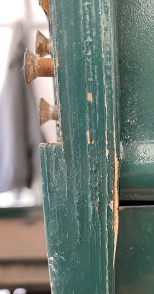

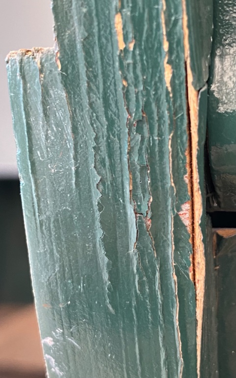

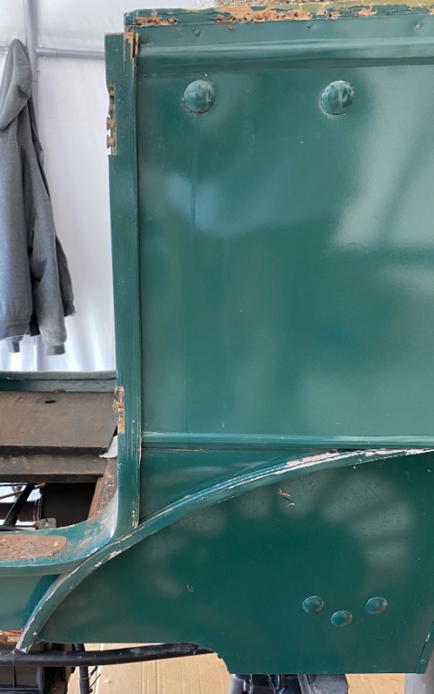

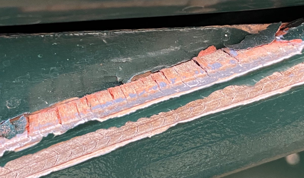

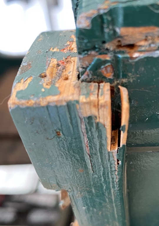

Hello fellow Model T-ers,
I am preparing my 1911 Touring car for paint (dark dark midnight blue).
Would any of you know of a “fix” to help shore up the exposed (delaminating) body plywood end-grain around the rear doors?

The best thing I know of is to pack some sanding dust into the cracks and holes then apply some super glue over the top, it will wick down into the sanding dust (you can use a clamp to tighten up the joint)
This repair will be stronger than the wood itself.

Moisture absorbs readily into wood, especially end-grain. The wood expands with moisture. Seasonal swelling and shrinking eventually causes the laminations to split. That's what we are seeing in your car. Unless you really seal the end grain, the failures will continue to happen if you just glue the laminations back together. The best repair is to glue and seal the laminations with an epoxy adhesive. In particular, the epoxy should be one that is formulated for some flexibility.
I have had a good deal of success with the West brand of epoxies manufactured by Gougeon Brothers, Inc. Best of all, the manufacturer maintains a toll-free help line where you can talk to a Technical Advisor. You will not be forwarded to a bunch of guys in a room in India. These are real people, with hands-on experience. The Advisor will be able to give you the best advice after seeing your excellent pictures. Tell him you have pictures and can email them.

Titebond makes a great exterior yellow wood glue (green label). First, blow off the areas with a compressed air nozzle to get any dirt out of the cracks. Where there are any missing plywood layers, cut some from some plywood that is the same thickness as the missing layer and stick the piece into the gap and trim to size. Squirt some Titebond exterior wood glue on the delaminated areas and press the glue in with your finger until the glue is all the way to the bottom of the crack. You may have to spread the delaminated layers open with razor knife blades to make a wide enough gap for the glue to be pressed into. Blowing it deep into the crack with compressed air works very well too. When the glue has been applied deep into the areas, take a wood clamp and squeeze the delaminated areas closed. Have a damp rag ready to wipe up any that squeezes out, especially be sure to get any glue off of the wood clamp so as not to glue the wood clamp to the plywood. Let it stand for several days until you are sure the glue has cured. This is a permanent repair. Jim Patrick

Not sure from the pictures but it looks like laminated strips with the grain oriented the same way, not really plywood, perhaps a modern work around to steaming and bending a single strip of wood or gluing up solid sections to make a curved strip. There are things you can do to try to keep it from getting worse, but that wood isn't sound and treating the edges will not make it so. If you glue the edges of the separated pieces, they may or may not hold, but the other laminations are probably going to let loose over the next few years. For a quality repair, replacing the wood with new would give the long term solution. Treating the cracks will likely only be a temporary fix.

I doubt it is plywood as plywood with alternating layers of uniform thickness layers didn’t become widely available until WWI. So it is reasonable to assume the body is not original. Glues prior to 1943 tended to fail when exposed to dampness.
By The best modern solution to your problem is the West system of two part epoxy. It will seal the end grain, adds some strength and takes paint very easily. The only difficulty is prior to drying it tends to run. When I repaired the rear panel on the 1909 body, I had to stand it on the firewall.

As you suggested, I called Greg in the technical department and he steered me towards their most viscous product, resin 105 with Hardner 206, mixed in a “mini pump” and injected into the delamination out of a small syringe.
I have confidence in this plan.
