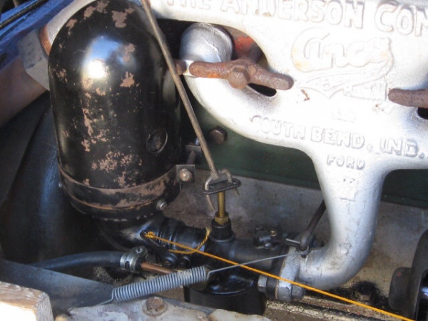

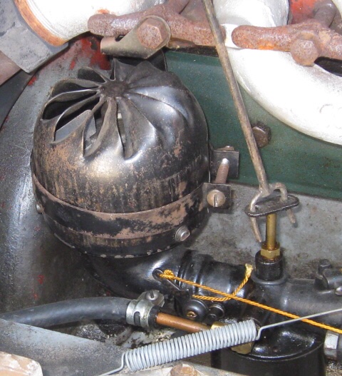

I found with this type filter which is against the hogs head a heater isn't needed. http://www.modeltford.com/item/CARB-FILT.aspx
1926 Tudor

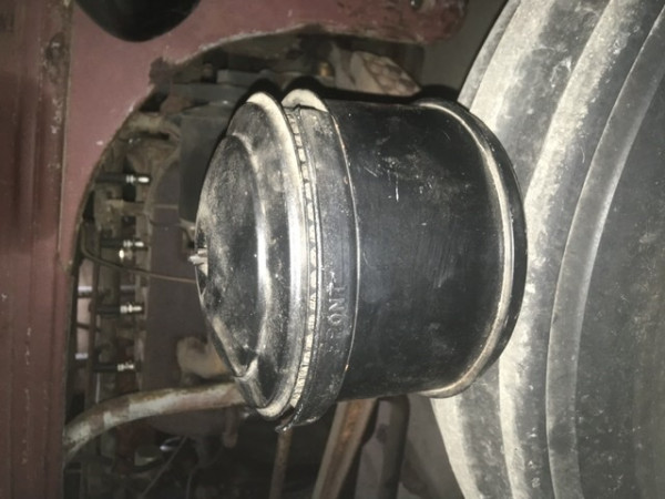

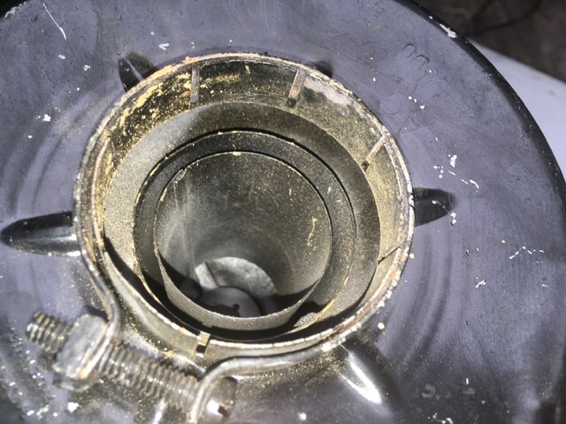

this is one I have. Not very restricted. Not sure how the guts work but looks like it has multiple tubes. Maybe it hooked to a heat stove somehow? 🤔

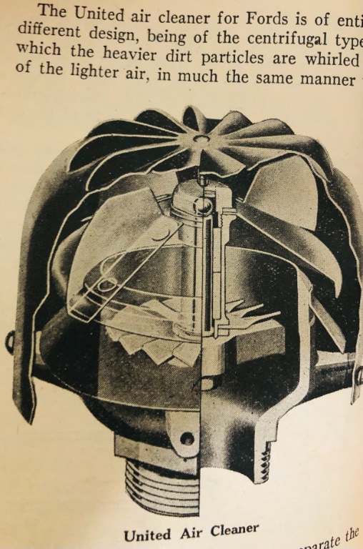

Posts: 4084
Re: AIR FILTER
Post by DanTreace » Wed Oct 13, 2021 1:44 pm
The Ford did have lots of aftermarket tries for air cleaners. Of course the Fordson Tractor used a water filled bath air 'washer' to remove particles of dirt and heavy dust from farming, but also added moisture to the intake air to help avoid pre-ignition and help vaporization and combustion. Each day the farmer had to drain that tank of muddy water.
With the Ford, the hot air pipe helps prevent heavy dirt particles from entering, plus the engine pans do some of that too. On my T's the use of both likely provides enough protection on today's roads. I off-road on dirt at times, but the dust is kicked up out the back. Fresh air is pouring over the engine from the radiator, that is high above the dirt road, with the engine pans, any dusty air exits low out the rear of the motor, and down. The hot air pipe entrance is high up on the exhaust manifold too.
For the one time I owned a Model A, I did place that accessory alum. body screen mesh wire air filter, seemed reasonable.
As for use of anything other than wire mesh or screen or these early ones that used channels and/or spinning action to throw dirt to the sides of these devices, IMO, could be concern.
I will agree with Scott on fire or flame. With gasoline vapor, there is high risk for combustion. The Ford carbs are 'puddle' carbs with the bowl full of gas, any excess fluid gas from over choke or backfire will exit the carb, at low side straight out. If the air cleaner isn't metal, that is a concern for me. A foam filter or a paper filter will absorb the liquid gasoline, and lay in waiting for some untoward issue to happen. Most foam or paper carb air filters are above the carb in modern use, the T isn't modern in that respect.
