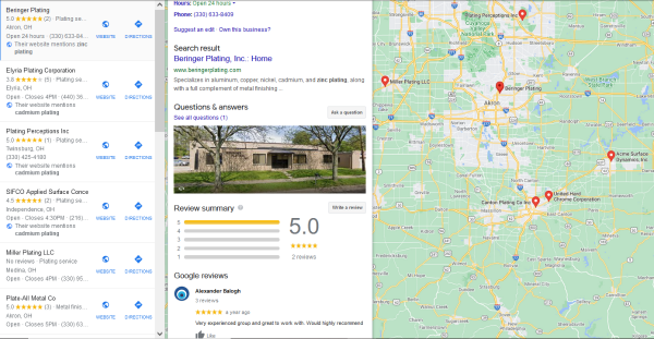

Can anyone recommend a good, reliable cadmium plating company ? The parts are small enough to ship, I am in Ohio.
“The trouble with retirement is that you never get a day off.” – Abe Lemons.
- Posts: 6544
Re: Cadmium Plating Service Needed
Not recommending - just did a Google search near you. This place has just 2 reviews both a 5!

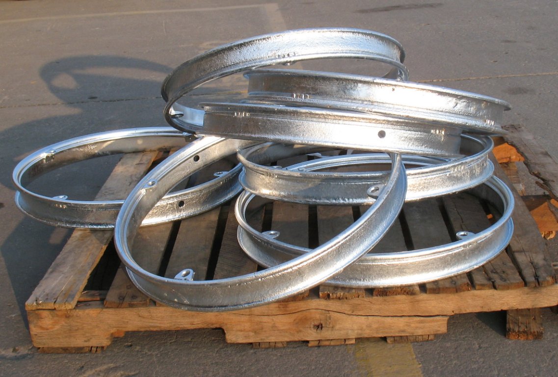

Since cad plating has been mentioned here, I'll take the opportunity to correct one of those Model T superstitions that refuse to die. Cadmium plating came into general commerical use in the thirties, after Model T production ended. Model T rims were NOT cad plated. They were galvanized.

What type of galvanizing would have been used on Model T rims?
Would it be hot or electroplated?
Harry
Harry
- Posts: 7394
I don't know. I had mine hot dipped.
- Posts: 7139
I have seen more far more electro plated zinc rims than hot dipped galvanised rims. Hot dipped rims are really scarce on our Canadian sourced cars.
The beauty of electro plating is it is generally much cheaper and does not usually require a big batch of rims to make it economical. It can be closely matched by painting with aluminised paints. When I want to refresh the look of electro plated rims, I brush a coat of aluminised paint straight over the plating. The disadvantage is the plating is not as durable as hot dip galvanising.
