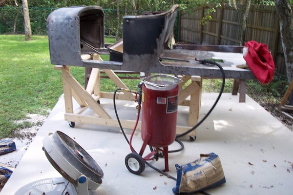

Sand blast for vintage heavy steel like our T’s is ok. Results completely depend on the skills and experience. So ask for previous customers on their results.
Took all the removable parts, fenders, aprons, hood shelves, hood panels, rad. shell to sandblaster/painter locally , he had just finished blasting entire body of vintage Mustang. Results were fine, he blasted off old layers and cleaned then primed with epoxy primer. All I needed to do was putty little spots, spray coat of filler primer, block wet/sand, then finish with sealer. Finish was so good decided to haul parts to local painter with spray booth who used my supplied enamel for the top coats!
Oh, I did chemical strip the body and doors as there was no rust, and my experience with sandblast on wood framed or metal framed bodies is that sand residue remains in crevices that you find rolling out of those spots after touring for a while

Sand blasting is now what I like others to do
, have done several bodies and fenders with simple gravity and pressure feed tanks, but in FL the humidity is awful.
Good sand blasting goes slow, as the pressure is low to prevent metal issues. Even with moisture traps, and heavy PVC lines, running up with drop lines and drain from the compressor, moisture (FL!)just causes issues in sand clogging, and the smallest grits can get clogged. Used bags of play sand, with fine mesh filter above the holding tank when loading. Hate it when the work is progressing well, and oops, the line clogs and you have to remove the head hood, respirator mask, uncover, unhook, take apart, and clean
For the effort, time and agony, have gotten rid of this equipment, and now use a professional!
