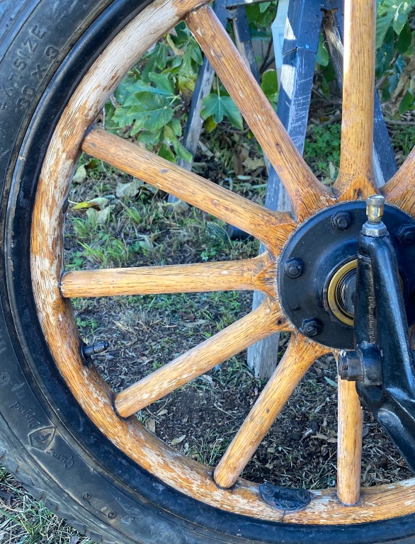

How do you strip the clear coat off a wood wheel without screwing it up for paint?
Hello fellow Model T-ers,
I want to strip these wheels of “whatever” the previous owner covered them with but I do not want to apply a chemical etc that will absorb into the wood and therefore cause problems with paint adhesion later. I also do not want to physically damage the wood by sandblasting.
Short of just folding up sand paper and going at it by hand, would any of you know of a way to remove the clear coat in a way that will not cause problems down the road? I would be grateful for any guidance that you may offer.

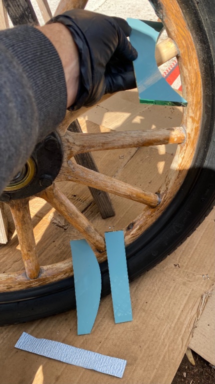

Per your advice, I picked up these shards of quarter inch thick mirror “for free” at my local glass shop. Along with some strips of 100 grit sandpaper, this failing clearcoat is coming off easily and completely with no damage to the wood or nasty residue..

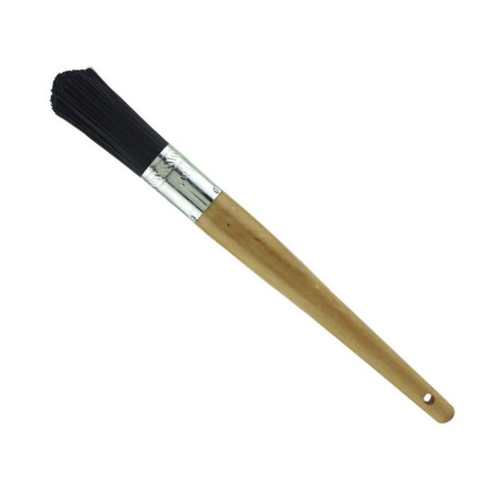

Scrape and sand off varnish as described by others, then using a 1” paint brush, clean bare wood with a wash of lacquer thinner to flow off wood dust and any remnants of remaining varnish. A stiff, but flexible plastic bristled parts cleaning brush (see photo) will also help in cleaning the wood grain and nooks and crannies between the spokes. The parts cleaning brush can be purchased at Lowe’s, Home Depot, Auto Zone or any auto parts store. With the thinner still wet, it will allow you to see how the spokes will look when clear coated. If the wood is still splotchy, do it again until the spokes are a uniform color with no splotchiness. When they are to your satisfaction, clean off any remaining residue with a cotton rag soaked with lacquer thinner. Once dry, lacquer thinner leaves absolutely no residue in or on the wood. Jim Patrick
