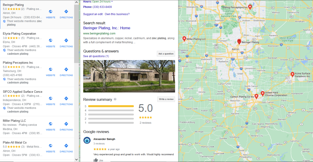

Can anyone recommend a good, reliable cadmium plating company ? The parts are small enough to ship, I am in Ohio.
“The trouble with retirement is that you never get a day off.” – Abe Lemons.
- Posts: 6394
Re: Cadmium Plating Service Needed
Not recommending - just did a Google search near you. This place has just 2 reviews both a 5!
