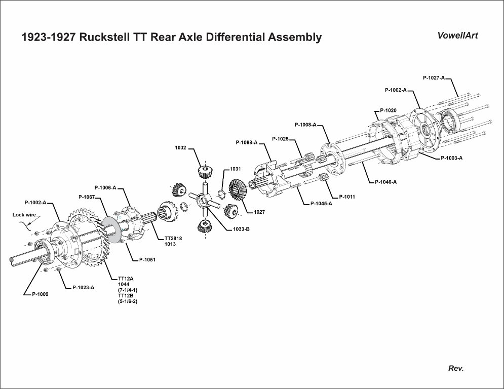

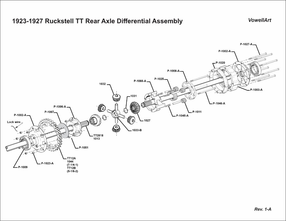

Later style 4 pinion differential. The addition of the extra two axis for the pinions made for a total redesign of the housing. Outwardly it looks pretty much the same, but in actuality has a thicker flange and the short screws are splined. The only thing I'd not sure of is if there were cotter pins on the nut side or lock wire like on the worm ring gear.
