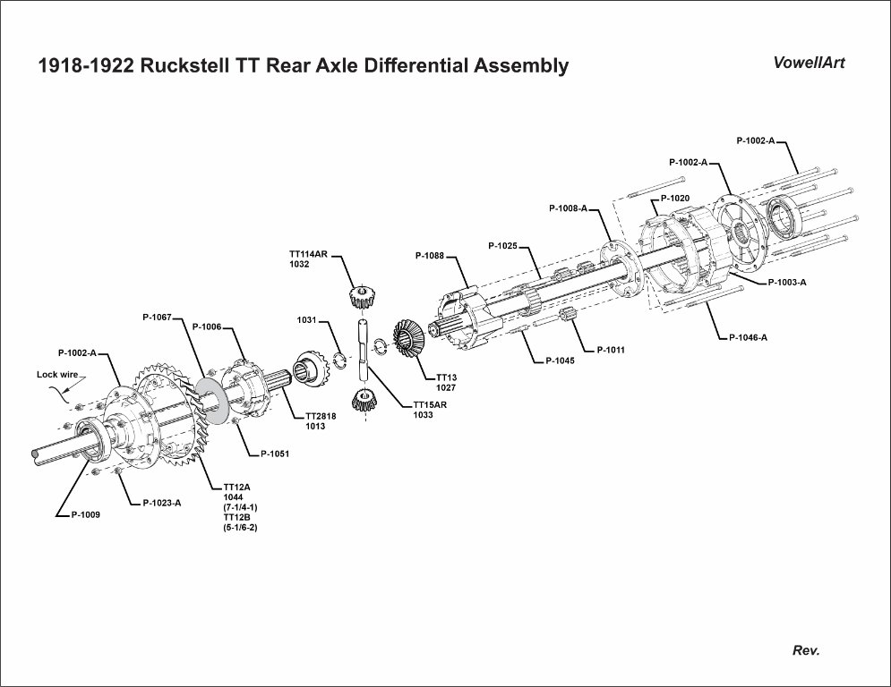

Does anybody know which part number go to which set of nuts? There is no description of where those two part numbers go....other than a rather muddy picture of no particular scale.
Also were the screws that held the differential housings together lock wired also?

Can't help with the numbers, but it is looking good!
The carrier for the 2 pinion shaft looks about right,

On these truck axle's does both axles use the ball bearing or only the rux side (I don't have the book but the fella that owns it does but I haven't looked at it yet). I thought I saw a video a while back were the original passenger side used an original bearing and thrust washer. If so does anyone know if those thrust washers available anywhere? I will be going over one of these this winter. Thank you for creating these beautiful breakdowns.
Tom

Post by VowellArt » Sun Oct 17, 2021 7:51 pm
Tom, both sides have same Thrust Bearing P-1009.

Thank you very much for the reply and the photo.
