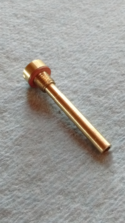

Today was jet day. It's remarkable some of the wrong parts that get jammed into these old carbs...this carb was fitted with Model A jets, and "no" they do not work correctly! The latest indignity that this carb was subjected to is being remedied today...

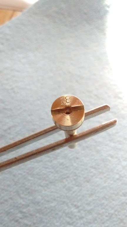

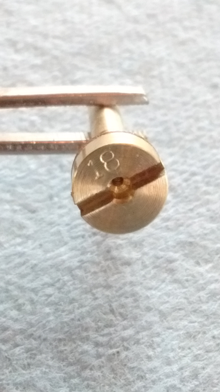

Zenith main jet dimensional first article (the entire part is barely over 1 1/4" long...for scale, the "18" is only 1/16" tall):
More futzy work in the shop today
