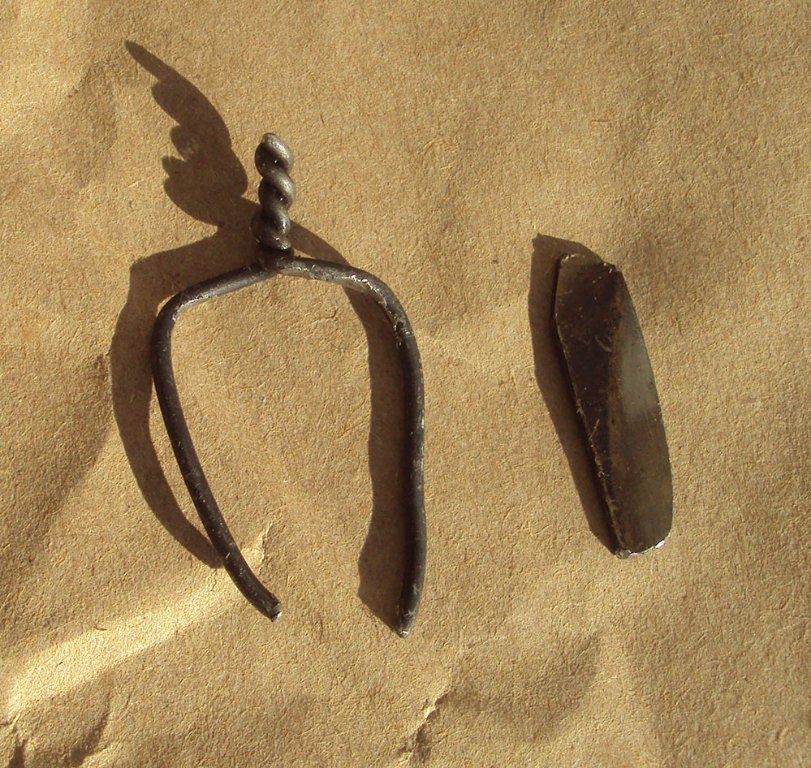

With the pan off and the engine upside down I found these in the center two pistons. I know what they are but am surprised. Can you recognize them?

Wire on the left WAS the wrist pin bolt retaining wire - not sure on the right piece. There's a reason the Ford manual shows a large cotter pin on that bolt !

I would not have guessed the piece at right. However, when assembling the high speed clutch discs, one large disc had 2 missing portions just that size missing just next to external notches for the brake drum lugs. As I had never seen that before, I suspected someone may have tried to improve it with a grinder. It didn't look broken and there were no cracks or distortion to that disc. I suspect another piece may have escaped my detection. The transmission was cleaned, inspected and reassembled. I don't plan to change out that disc now.
No matter how many times we rebuild these things there are always new occurrences to entertain us.
