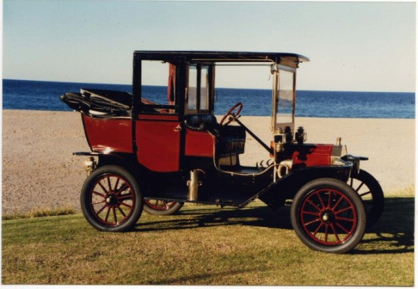

I built a very similar Town car 50 years ago, this one like mine is a mixture of parts and not correct in lots of ways But like mine would be great to drive if the mechanics are done properly. Several builders supplies these bodies originally , they all vary slightly and as is often the case some restorers get details wrong. This one, no back window, no jump seats inside, windscreen does not slide up over drivers head., Laundau irons on roof fold wrong way to name a few. As to weight these bodies were not much heavier than a touring , mine is actually lighter.
I can see a few mistakes but they can be changed if one has to have it "correct" , my TC also has the wrong year block in it but it has always been a driver has done thousands of miles, still starts first pull of the crank even after months in storage. As mentioned most have no concept if something is exactly as it is supposed to be but this TC has had lots of money and attention applied to it and as Ron Mac stated all those bits add up to heaps of money plus the labor.
Having one for so long and also having been able to see original ones I consider I have a good knowledge of these early Town Cars. If someone had the ability to purchase this TC it would be a good buy, I really object to the loading of the price with a 12.5 % premium. Owner may find that stops it selling.
