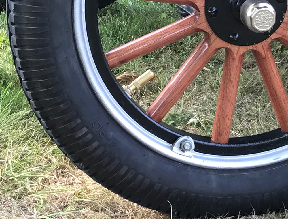

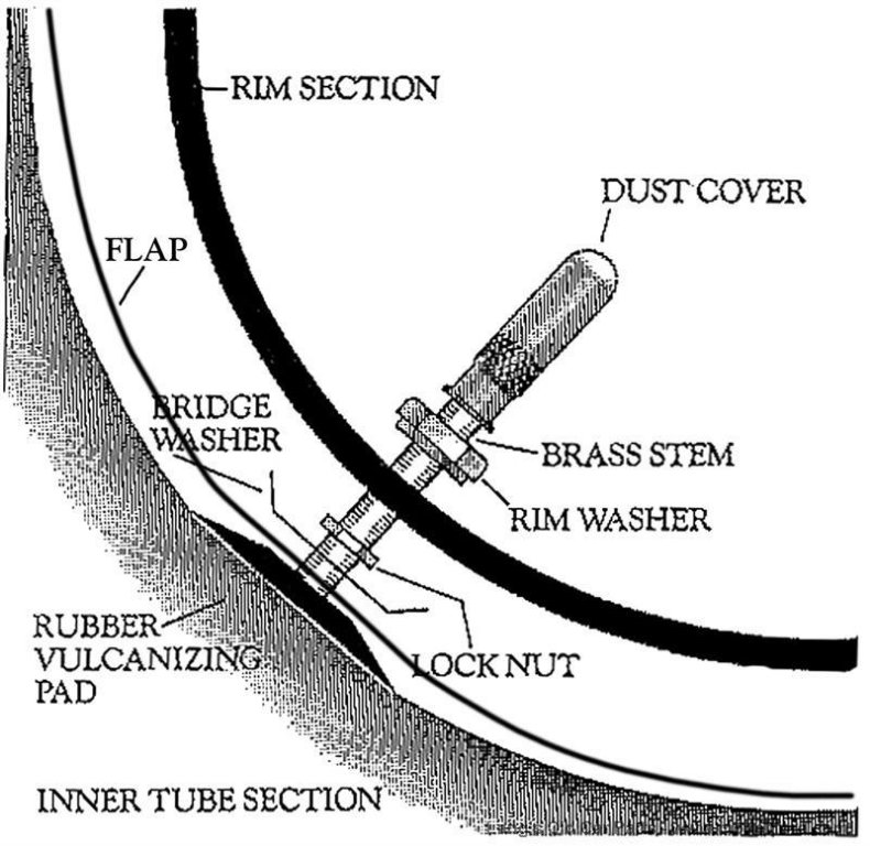

Post by Oldav8tor » Sat Oct 23, 2021 9:44 pm
I tried rubber stemmed Hartfords - had two flats due to stem failure. The problem was, the edges of the clincher come so close together that they can cut the stem over time (first photo).
An "old time" solution is to grind a bit off the bead to provide relief for the stem (second photo.)
My final solution was to buy new Blockley brass-stemmed tubes (best available in my opinion) which won't be cut by the bead. I installed flaps along with a bridge washer on the stem to prevent the tube from bulging down into the space between the clincher beads which I think must reduce wear and strain on the tube. For that and the reasons expressed by others I will continue to use flaps.

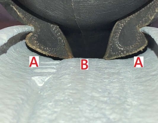

Not all tubes have the same diameter, even if marked for 30x3-1/2. I have worked with some, that there was no way to keep the tube in the tire when mounting if flaps had not been in place. They just wanted to pull out of the tire, because were more like for a 28/29" tire.
The photos above that show the cross-section, is a good illustration of what can happen with some brands of tires, not all of them have a bead that fully encloses the tube.

I have Blockley tubes. I put balance beads in the tubes and replaced the Schrader valve with the "special" one that comes with the balance bead kit. Perfect fit!
I also installed valve stem covers that I purchased from Lang's. Also a perfect fit.
IMO, the job Blockley does attaching the valve stem to the tube is far superior to anything I could do with an original valve stem purchased at a swap meet. With the valve cover installed you can't tell the difference from the original style.

The Blockley Tubes I have here are exactly as described on the companies describes on their web page.
The Brass Stem is beautifully installed (as others have mentioned) and is the TR383 which I believe is the Schroder number?
but either way it is 3” in length and 1/2” in Diameter. I too bought the Valve covers off Lang’s and the combination is perfect.
It’s all about the service life and confidence of safety that a quality product provides and not a Valve Stem that’s too long, short

Yup. DC-1 cap and RW-1 rim nut. I found some leather washers at Oshkosh and have one between the nut and the felloe and another between the cap and the nut. When installing the tube I used flaps, then a bridge washer in the space between the flap and the rim.

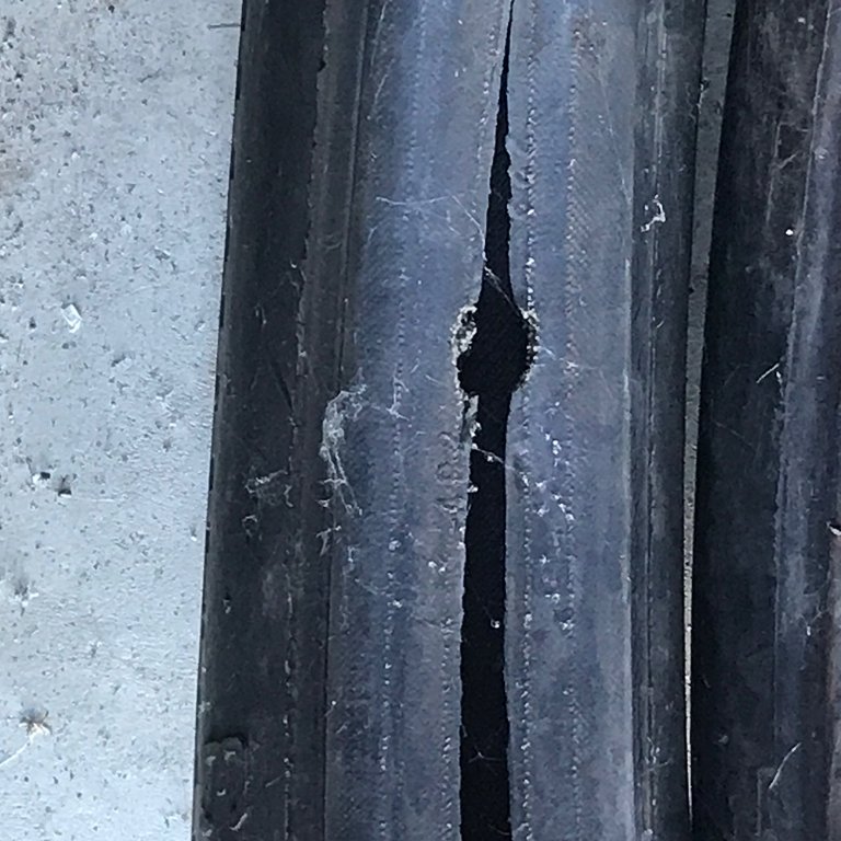

I put a Custom Classic tube in yesterday. Had a hell of a time getting the tire on, and I've been doing this for over 60 years! I don't see how these tubes fit three sizes of tires. Maybe that is why it was so difficult for me to mount the tire? I just went out the the garage a few minutes ago, and the tire still has air in it! What a relief.
I think Stan Lucas should approach an American tire company about making tubes, and maybe tires here in the USA again. We have got to be using more tires and tubes today than back in the sixties when you could still buy them from Montgomery Wards.

Did you know if the bridge washer and lock nut from Lang's will fit on Blockley tires as well ?
Oldav8tor wrote:
Thu Nov 04, 2021 4:45 am

Yes, I got the bridge washers from Langs. Blockley does not supply them. I installed the tube according to this diagram:

I hope you got a good one. There was a run of those that were prone to splitting. I was slow to learn. I patched one seven times before I finally figured out what was going on and tossed it. I'm avoiding Custom Classics just in case any of those splitters are still in stock.
