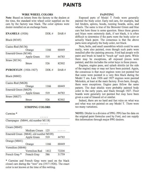

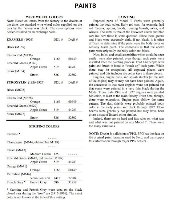

You'll need to decide how authentic a paint finish you want for "type" of paint
https://mtfca.com/encyclo/P-R.htm
Paint Number Charts follow
Paints 1.jpg (83.37 KiB) Viewed 5502 times

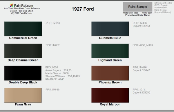

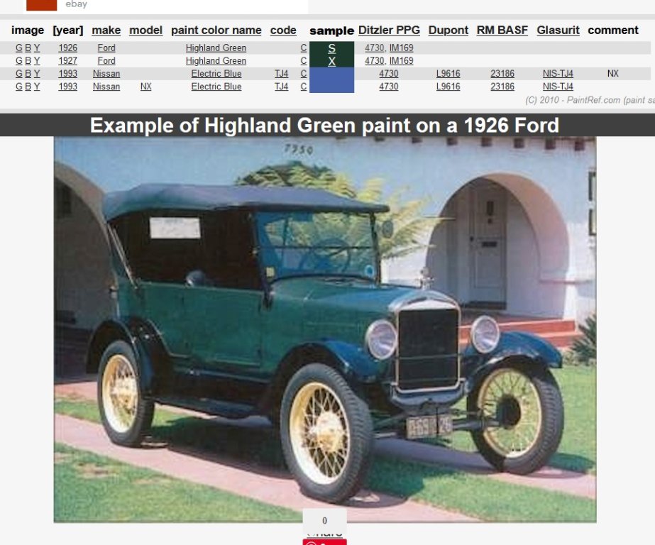

Not all computer screens display the same, but the comparisons of some of these artist renderings to the color chart can give you an idea of the color. You can then get some actual color chips
http://paintref.com/cgi-bin/colorcodedi ... 730&scomm=

Names are inadequate to determine a color. One company's Lime Green is another company's Envy Green. Go by the numbers in the Encyclopedia. You can also have a color mixed to match a sample if you have one. Most paint stores now have the technology to read a sample and match it.

I see that they have used my '26 Touring as an example for Highland Green in the photo above.
That photo was taken for a magazine article highlighting the last years of the Model T. We used a house in the city of Downey as the backdrop. The photographer wasn't familiar with the area, so I drove to "Downtown" Downey, near the intersections of Firestone and Paramount Boulevards. This area was developed in the '20s and '30s. The house fit right in to the era complete with ribbon driveway. Only thing is, most likely the people that could afford a house like that when the house was a few years old probably would have owned a car a little more expensive than a T.

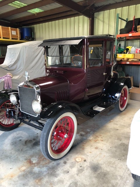

Here is another version of Mike’s picture. It looks better with the rubber side down. Beautiful T! Jim Patrick

Thanks Jim. I have never figured out why some of my photos show up here sideways!
