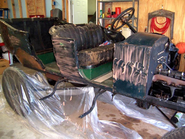

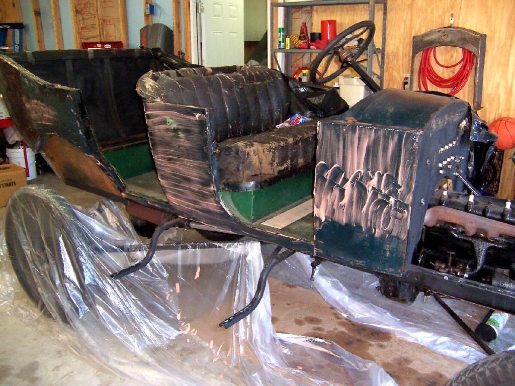

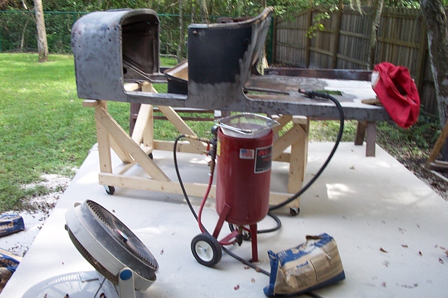

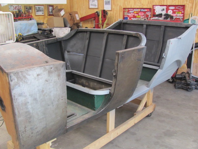

My only body blasting was with a runabout, home unit, and took a while to do. The results were pleasing and of course a lot of hand sanding or orbital power was needed after the blast. Then prime, sand, prime fill, sand, prime, sand and sand and sand
The only concern after was for quite a while, fine white 'play' sand would shake out of the body cervices and land on the running boards. For that reason, went to chemical removal, was easy and of course the hand sanding had to be done anyway. But, no blast sand fell out of cracks!

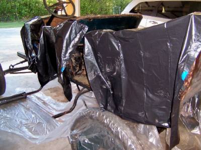

Chemical using CitriStrip, plastic prevents early drying of the stripper.
