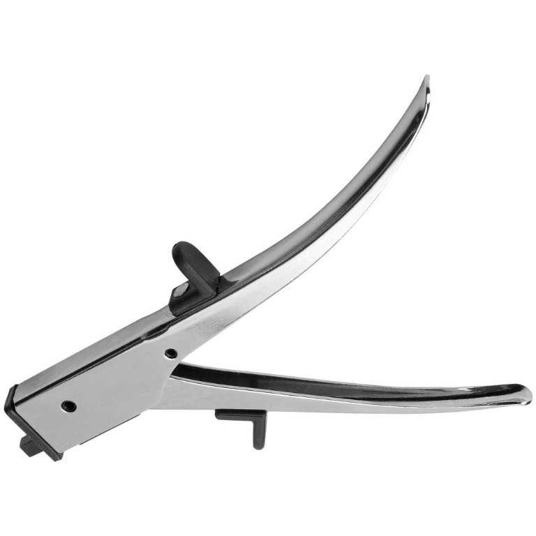

I saw the clutch that Joe is referencing, the clutch material on the disc was gone. You can go old school like I did some 20 years ago (still in the car, but I don't put nearly as many miles as before) using a hand nibbler and a bucket of old clutch discs that a transmission builder gave to me free and make your own, but like any manual clutch, if you ride the pedal or have a weak clutch spring they will wear quickly. Just my humble opinion, enjoy
