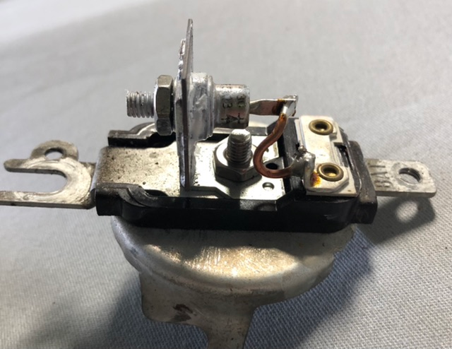

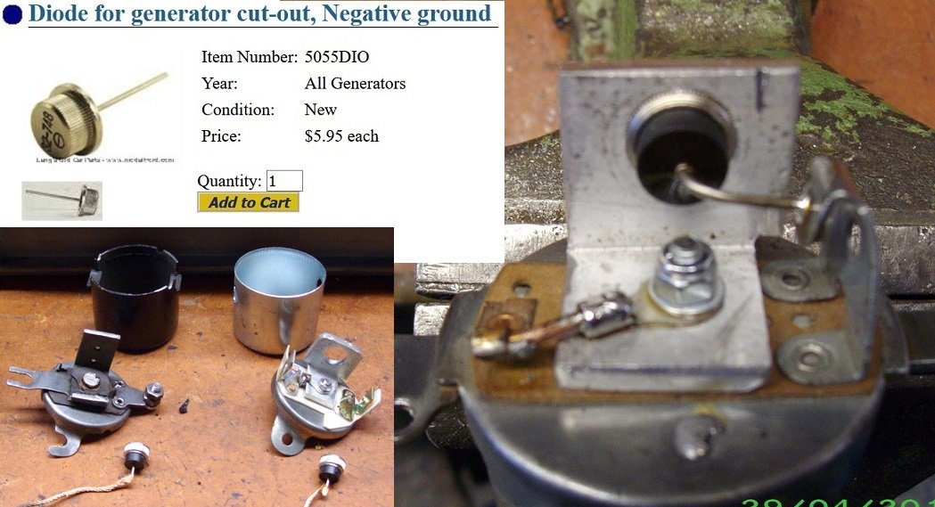

Its really easy to update a cut-out with a diode. Some internal styles may make it a little harder. While the solenoid and diode both prevent the generator from motoring when the engine is turned off there is a difference in continuity testing. The solenoid is an electronic switch that opens or closes based on voltage output from the generator. So when the switch is open there is no continuity across the cut-out contacts.
A diode operates as a voltage check valve, so when the engine is turned off battery current can't pass back into the generator and spin it like a motor. However, it will always show continuity across the cut-out contacts because its designed to allow current to flow in that direction.
This may sound weird, but since there is continuity but no current across the diode the negative battery cable will spark when you reconnect it. Not to worry

The diode shown here is a bit weak for my taste. I use one with a 10/32 stud. A very recent post showed it on a sample unit. I dont recall the value ratings off the top. The heavier diode does create more heat, but I vent the back side of the cover. Not had a problem yet. Also, the wire connections are physically set before solder. I have seen other units come unsoldered.TRDxB2 wrote: ↑Tue Oct 26, 2021 5:53 pmIts really easy to update a cut-out with a diode. Some internal styles may make it a little harder. While the solenoid and diode both prevent the generator from motoring when the engine is turned off there is a difference in continuity testing. The solenoid is an electronic switch that opens or closes based on voltage output from the generator. So when the switch is open there is no continuity across the cut-out contacts.
If I reverse the probes with my meter, is shows continuity in 1 direction. The flow of current thru it.
