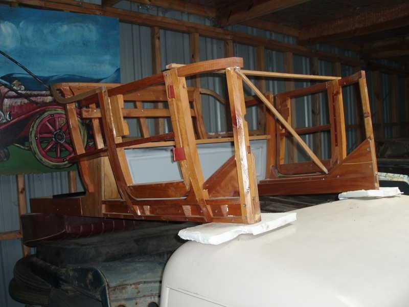

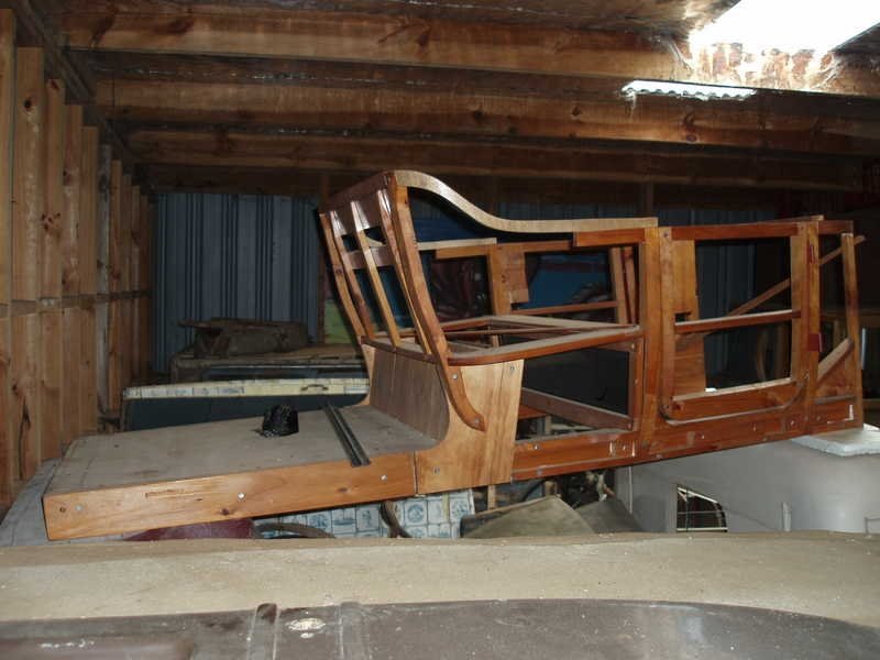

It is not a touring, but here are some harvested images of 1914 runabout wood:

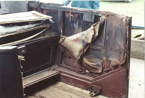

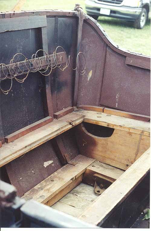

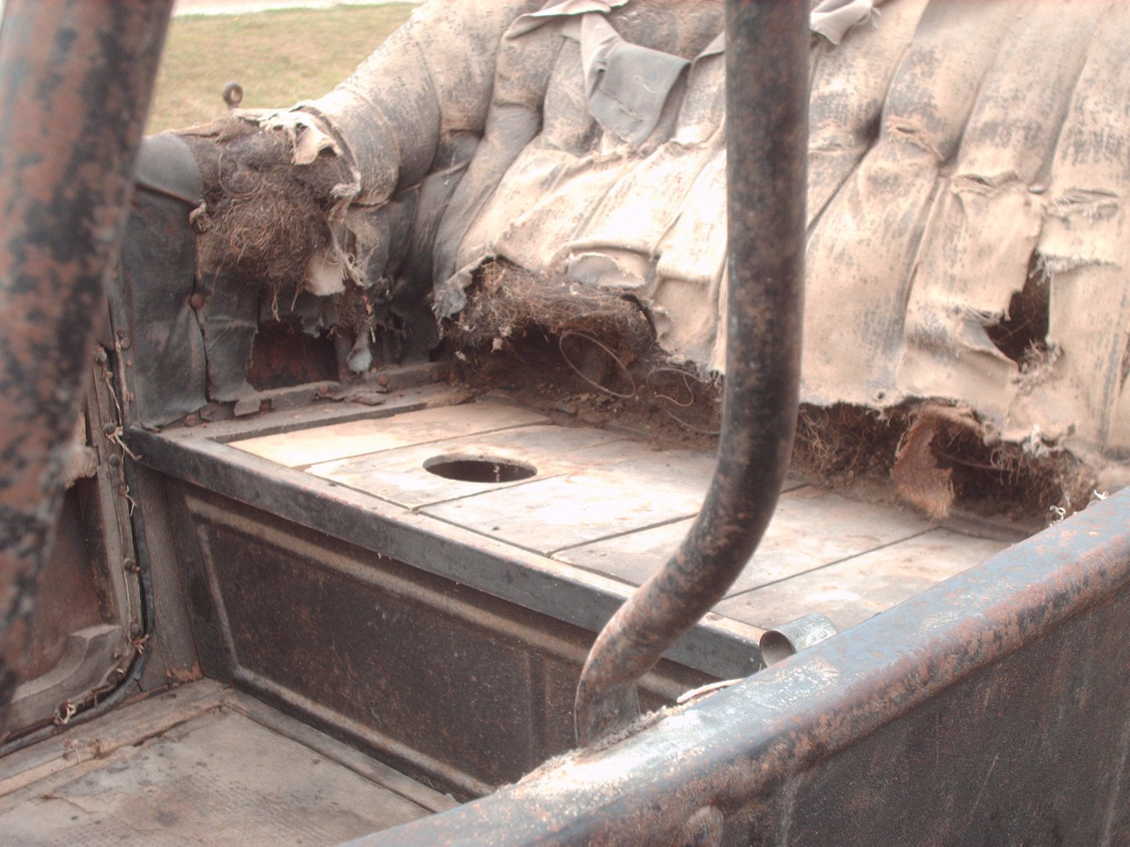

Here are some touring images:
1914 body drivers inside.jpg (44.05 KiB) Viewed 5329 times
Can you post some picture of the parts you don't know where they go?
