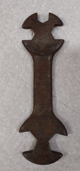

I have some tools from tool kit that are rusting. I would like to protect them and make them look original. Did they come from the factory parkerized, or some other finish?

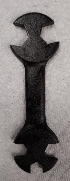

This was a fun experiment. I took a rusty wrench, lightly went after loose rust with a wire brush, heated it with a rosebud torch until it turned a dark red color, immersed it in engine oil, and success, rust gone and a nice black finish.

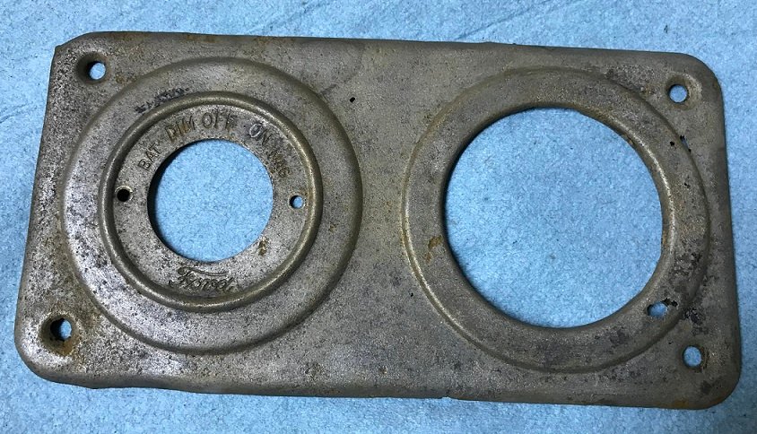

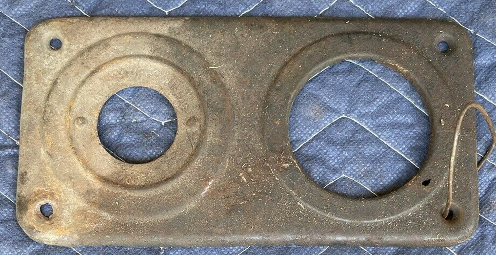

I usually soak parts of a 1/2hour or up to 24hrs depends on thickness of rust. Cleaning grease and old paint will prolong the use of the product. I use a variety of methods to de-rust (except sandblast). Evapo-Rust when I want to preserve paint, a dissolver, reformer or electrolysis tank . This is an example of using Krud Kutter Rust Remover soaked for 24 hrs (they also have a spray). Just before I pulled it out you could actually see an impression of the plate made by the rust scale floating on top, wish I took a picture. So it wasn't cleaned before, wouldn't come off. I did need to wire brush the soft black residue after I took it out to get what you see. I did that 3 days ago, picture was taken Today. --speedytinc wrote: ↑Fri Oct 29, 2021 5:38 pmI have parkerizing chemicals also for restoring harley parts. The process is a PITA. Involving a temperature controlled pot, no touch of blasted parts, cleaning & oil baths. A bunch of specific steps. Depending on expected storage or tool usage I have used lazier methods.
Wire wheel or bead blast & paint flat black or wash in my greasy solvent sink. Repeat as needed when they get too ugly.
That Rustoleum product looks interesting for use on cleaned metal.
Hydrolysis Tank used for larger parts and to dissolve rust from inaccessible areas like jacks, rim spreaders, door locks . Cheep way to derust them
