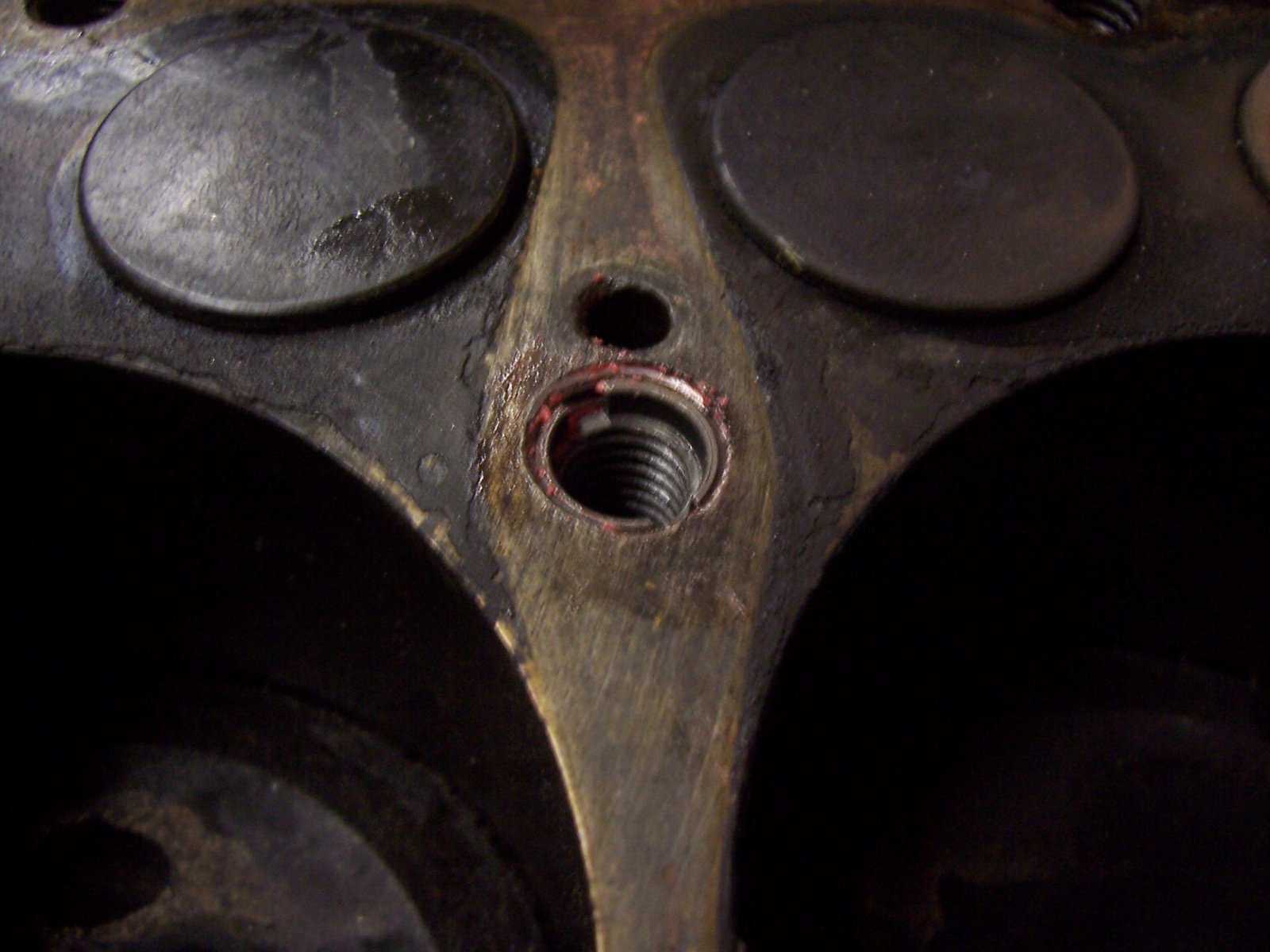

Post by mbowen » Sat Oct 23, 2021 5:12 pm
kelly mt wrote:
Thu Apr 04, 2019 7:39 pm
I used this thread repair on my last problem. I like them better than Helicoils. One caution, one experienced guy on here has said to be careful as some thread holes are close to the water jacket. Ez-Lok from McMaster Car.
I need to repair one head bolt hole in my 1925 block, the one just outboard of the valves for #4 cylinder. I plan to use the “standard wall” 7/16-14 EZ Lok insert which uses a .531 (17/32”) tap drill, which precludes using the head as a drill guide. How do I best assure the hole gets properly located and aligned?
Miles

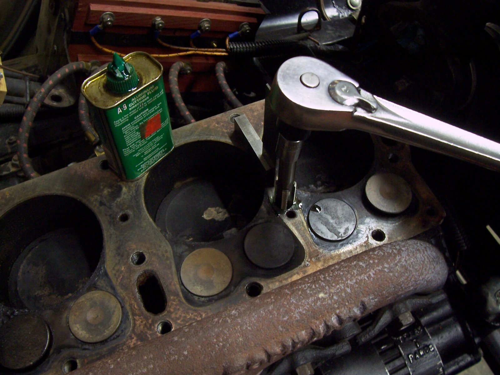

Post by Jerry VanOoteghem » Sat Oct 23, 2021 5:24 pm
Miles,
You might try using the cylinder head as a drill guide. I know the hole in the head is not big enough for the EZ Lock insert, but if you drill as large as the head will allow, it may clean up the hole enough so that redrilling with the larger drill will locate as it should.
Thank you Jerry. I thought of trying that, but with the top of the hole already around a half inch, and oblong, I wasn’t sure the 0.531 drill would self-center properly.
How about if I take that cracked head I have and have that hole location bored out to 0.531, and use that as a drill guide?

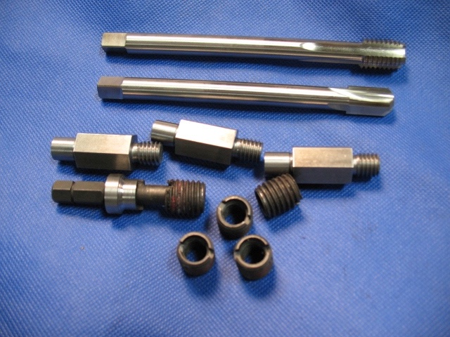

Post by Dan Hatch » Sun Oct 24, 2021 9:09 am
Here is a picture of the Lock n Stitch alignment fixture.
Here is picture of the Stevens kit I made a few years ago.
I still have some of the spacers for the head if you need.

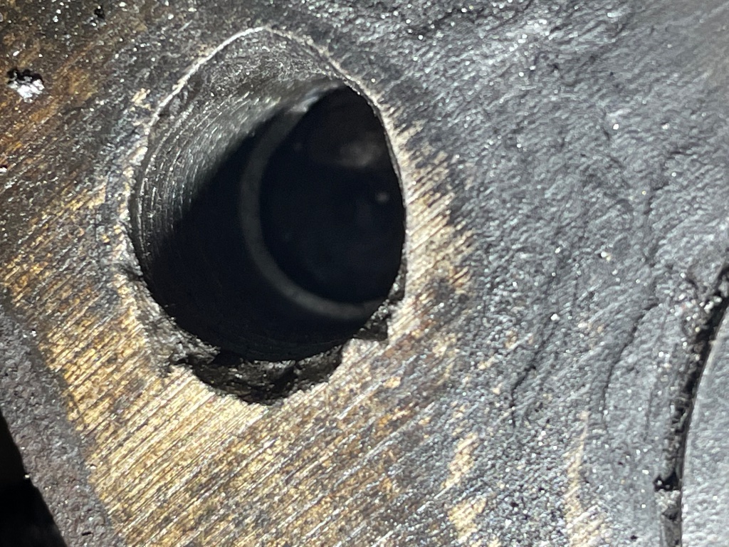

Post by mbowen » Sat Oct 30, 2021 12:18 pm

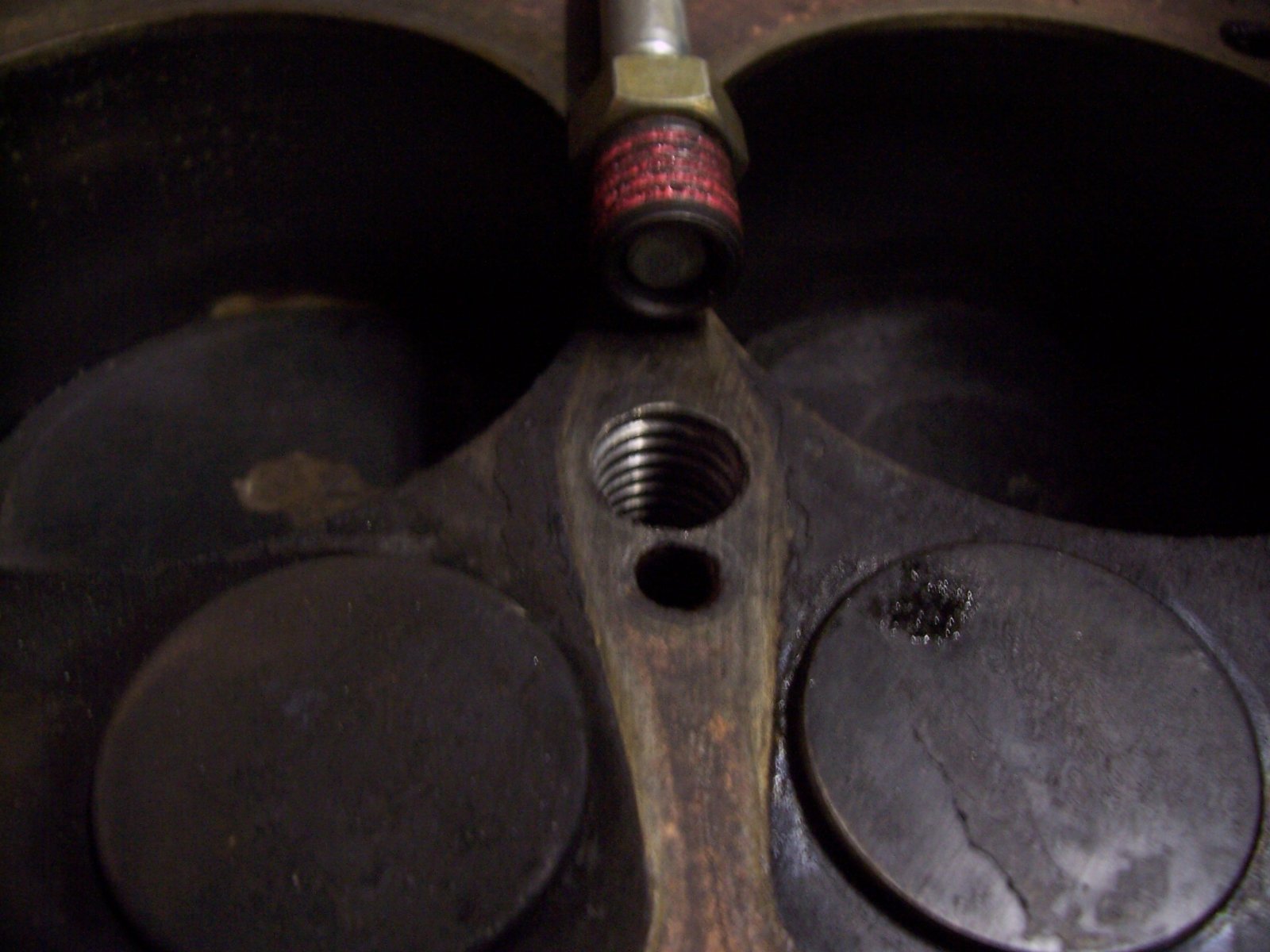

The photo below is AFTER I cleaned up the hole with a 29/64 bit, using the head as a drill guide. There’s very little cleanup, except that what little bit of thread that previously allowed the bolt to snug up is gone. There is still noticeable wobble of the 29/32 bit in the hole with the head off, so I’m not going to chance the Helicoil brand and go with EZ Lok.
Miles
1924 Touring “Bonnie”
1925 Express Wagon “Clyde”
Posts: 5268
First Name: john
Last Name: karvaly
Location: orange, ca
Re: Stripped threads in block
Post by speedytinc » Sat Oct 30, 2021 12:55 pm
Helicoil is always my first choice. In this case, clearly not an option.
I like the idea of sacrificing an old $10 head as a drill guide. Another head slap. One could hang onto it for different blocks down the road.
Better use than for the boat.
