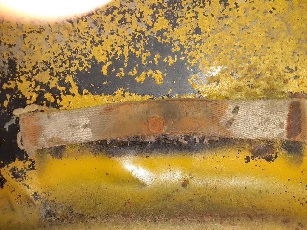

Attached is a photo of the pad between the rear spring and the bottom of the body on my 1927 coupe. I have not found one in the suppliers catalogs. I probably can reuse it or make one, but I was wondering if anyone knows of a replacement.

That pad is between the frame, (not the spring), and the body. Not aware if one even belongs there, but others will know for sure.

Yes there should be a pad between the frame and the body, attached to the bottom of the trunk floor, but you will have to make your own.

With a yellow body, it is safe to say that THAT particular pad is not original. With respect to whether or not one belongs there at all, I'd say that if it is not riveted to the body, then it does not belong there. At the speed that cars were being assembled, I cannot imagine that something was laid on the frame to be captured by the body, nor can I imagine that it was glued to the body when there is scant evidence that glue was used at all in the fabrication outside of the Linderman wood joints which would have been done early in the processing of the raw wood manufacture.
I can see advantages of having a pad IF there is interference between body/frame, but that area should be a clearance area in the first place

Scott, the body pad is riveted to the trunk floor. Factory installed. Keeps floor from squeeking under load.

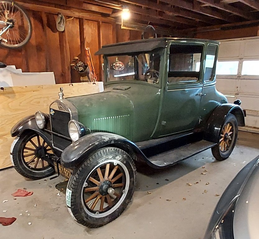

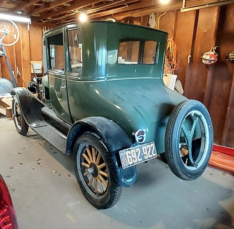

Jeff, I am interested in the paint shown in your photo. Is that in a 1926 or 1927 couple? Is it the original paint?

It’s anti-squeak material, as Jeff said and you can see rivets turned over in the original pic. Should be rot resistant , and sometimes army surplus places have it in real dark olive drab, also treated. If you cannot find it, I think I have a foot somewhere and would be glad to send to you. Tmorsher@icloud.com if I can help

Bruce, my coupe is a 1926, repainted 50 years ago in what was then thought to be channel green, model A kewanee green per the Les Henry Restoration Handbook.

Jeff, Can you post a photo of the outside of your car so I can see the paint?

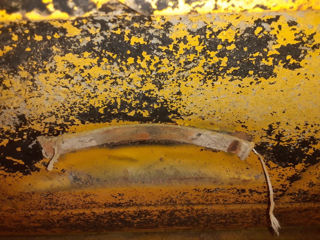

Post by BLB27 » Mon Nov 01, 2021 9:31 pm
Here is another photo of the pad.

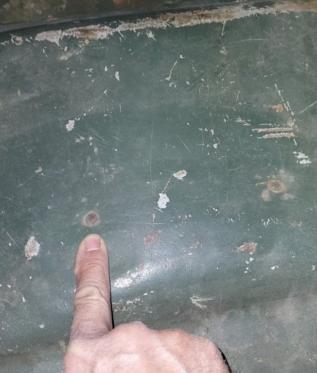

Post by Humblej » Tue Nov 02, 2021 9:52 am
Bruce, pictures as you requested.
