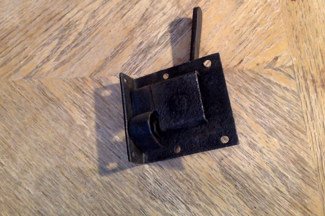

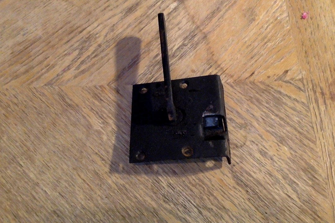

Could this door handle be repaired? It is from my 1916 Model T touring. The two pieces appear to be soldered together. Although the handle itself is good the spring mechanism has gone bad, and every time I get a few feet down the road the door swings open. What can be done?

I'm pretty sure nothing has been soldered together, at least not originally. The back cover should have small tabs that fit into small slots on the mounting plate. Those tabs would have extended through the mounting plate just a bit when first assembled. Then the tabs got peened over. You can try grinding off the peened part of the tabs, tapping or prying the cover off, installing a new spring, then brazing the assembly together.

Re: Door handle repair
This is a later one to give an idea what it looks like to any who haven't seen one. I'm sure Charlie's is a good method and I will try it. I'll still narrow them a little with a chisel first. Grinding the tabs would leave less metal to peen over so consider not doing that.
