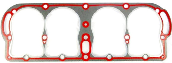

Generally those new 'silicone' strip gaskets aren't recommenced on the high compression heads is for the possibility of leaks. The sealing area on the silicone ( you can't add any gasket sealer to these like Copercoat) is a very thin line, that is risky for higher compressions, and/or block and head that haven't been surfaced to flat square and smooth.
Note too, the silicone red sealing strips aren't between the cylinders, where risk of blow-out is a concern.
Note the narrow red lines (silicone strip), that is the only sealing area on the silicone gaskets.
As for adapters, typically those extend into the compression chamber and run the risk of putting the plug or adapter too deep, affecting performance or interference.

The silicone gaskets I got from Tom Carnagee 10+years ago look similar, but the red lines may be wider. The base is a darker olive brown & stickey like a varnished/silicone coat. They dont appear or sound the same as the new style. Are the new offerings a poorer quality counter fitted product that will displace a better part? Cant be sure enough to say now. If I get my hands one one, ill know for sure. May ask T.C.
Why dont they have a line of silicone around the chambers?? The recommended torque is #45 for aluminum heads. Sounds light.
