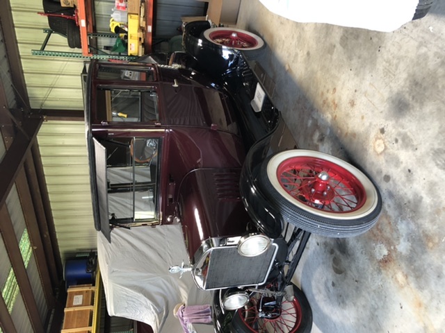

Cannot find any pictures in my books and this one window is stuck solid and I cannot get it to move. The sliding side piece unlocks fine but no amount of pressure downward gets the glass to move. Even slid a sharp knife between the glass and felt to make sure the glass was not stuck to the felt. Passenger side works fine but the drivers side will not move. I guess I will take the seat out, then the panel on the wall but looking down with a flashlight into the area shows no obstruction. Any ideas before I break something?

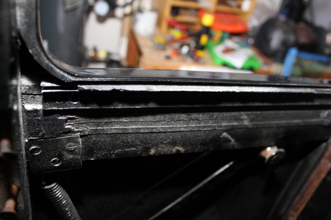

This shows the lower portion with no glass. It might help seeing what is down there. The glass channel is cocked a bit.
http://www.mtfca.com/discus/messages/29/33159.jpg
From Mike Curtis on:
http://www.mtfca.com/discus/messages/29/32888.html

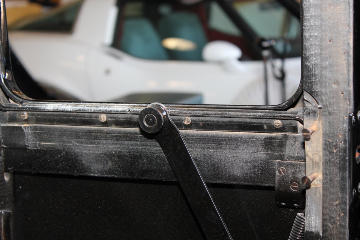

This is a '23 Fordor rear quarter. It's similar and may show what's going no there clearer.

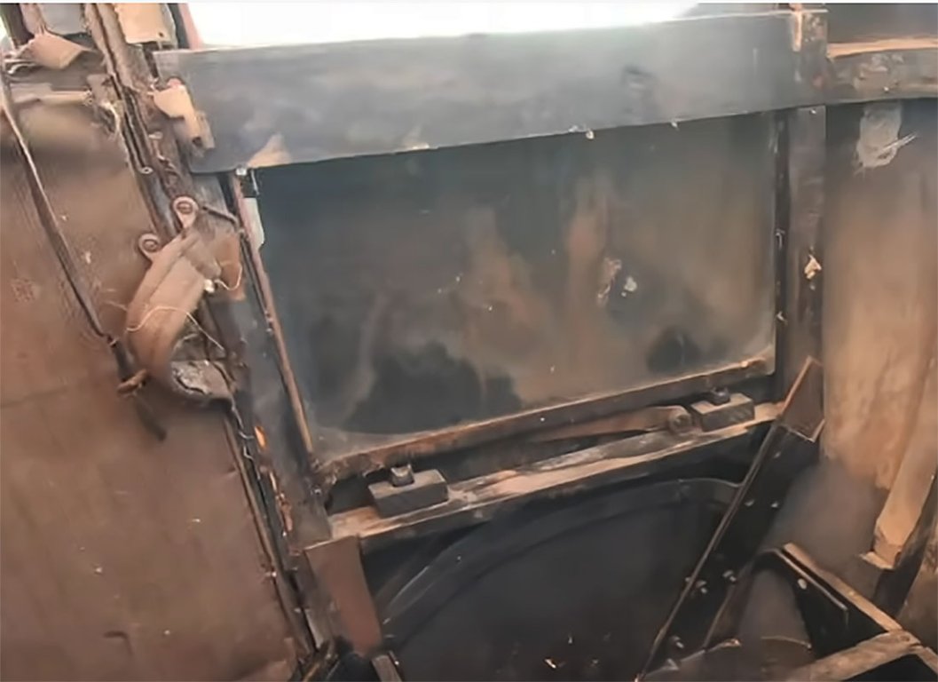

Perhaps the spring-loaded arm (roller should be under the bottom window frame) which assists in raising the window has slipped to the outside of the window, thus jamming it. Another possibility is that the roller on the arm has broken or chipped, but that shouldn't stop the window from working, just making it more difficult. Can't find all my photos of that area on my '25 coupe, but perhaps these, along with others posted, would help visualized what is happening. Upholstery side panel likely will have to be loosened.
