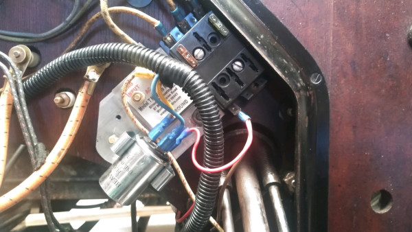

I'm using this on the 6 Volt '13
https://www.snydersantiqueauto.com/prod ... 82457&cat=
here is it installed in the Car..
The Car already had been converted with 6 Volt Turn Sig, but no Charging or fuses.. So I was able to add a few things I thought were necessary..

Part # T-5165-6 | Model Year 09-27Cap wrote: ↑Sun Oct 31, 2021 10:27 amI'm using this on the 6 Volt '13

"Finally a way for you guys with early non-starter T's to be able to charge your hot-shot or accessory battery. Charges battery with current supplied from the magneto post. Not recommended for use with original style ignitions/coils. Limited supply of these 6-volt units available. U.S.A."
Interesting disclaimer. The perfect product not recommended with a stock ignition/coils.
Cap

Interesting..I've missed that disclaimer..
I am running an E Timer on this car, so it's always on battery.. I reconfigured the wiring in the battery box to be battery on both sides of the switch..
I'd like to see the waveform out of the mag with the 'device' and without to see what might be the issue..
I understand the "hot Shot" charger does not have this limitation..

I did the same setup on a 15 motor in a 24, charging an 8V battery. Same numbers. This one has only a few miles so far.
