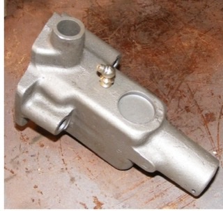

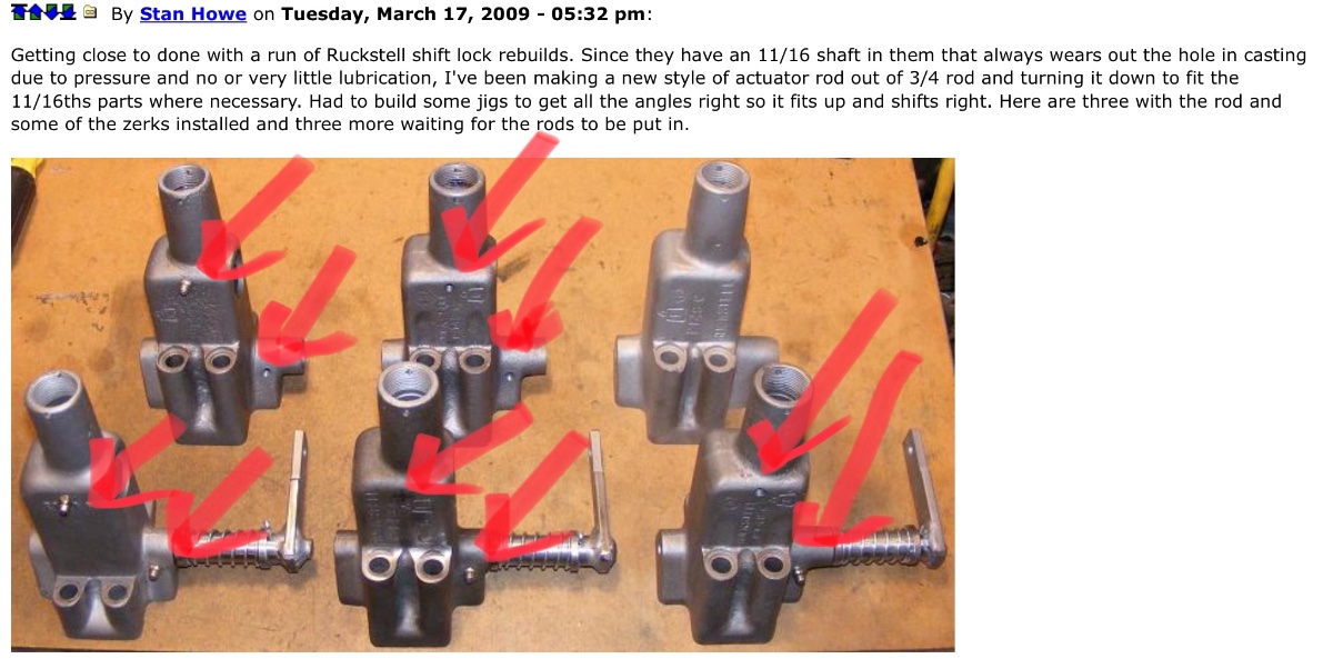

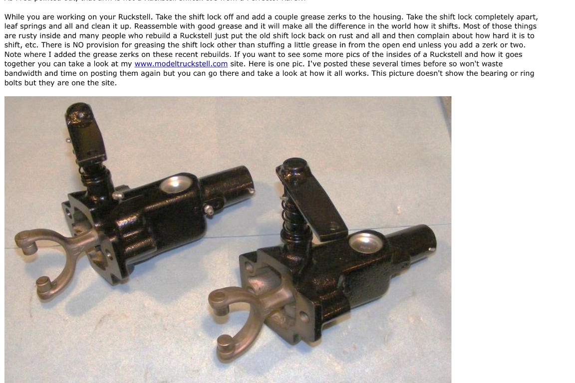

It will not do much good except pump grease into the axle in the first pic. Look closely at stans pic, two fitting right there will do the trick. You can use little button fittings that you drive in a hole, very inconspicuous that way, and it delivers grease right where you want it.

Re: Location of Grease Fittings on Ruckstell Shifter Housing…
Aye, there’s the rub, Larry HOWEVER! …………. Of course the early style doesn’t need extra lubrication. Stan had it correct.
