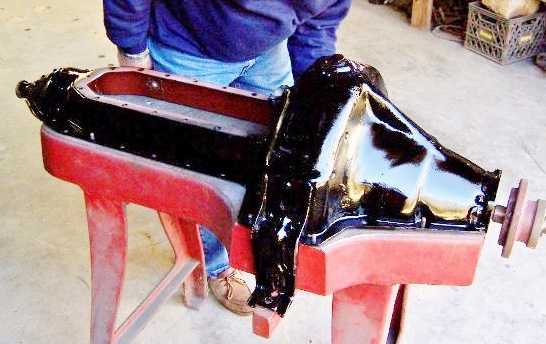

Fortunate on this '26 pan, cleaned, painted and Glyptol'ed the inside. Had checked it manually on my home garage 'pan checker', made from an unusable '26 block, bolted to an unusable '26 hogshead. Those 2 block to hogshead bolts makes a good tight combo with the full flat surfaces to 'check' a pan for gross out of whack.
Then took the finished pan to another T'er who had a KRW jig, to do the final check/adjusting, didn't need any more attention, everything luckily lined up :D
