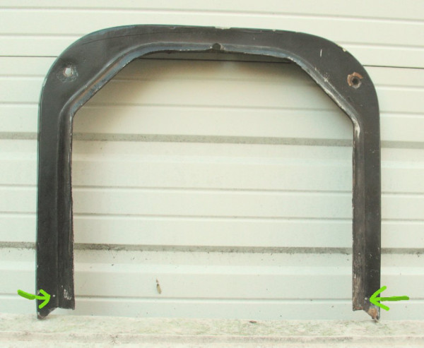

15/16 Hood former question
Topic author - Posts: 7403
What belongs in these two little holes?
Kerry

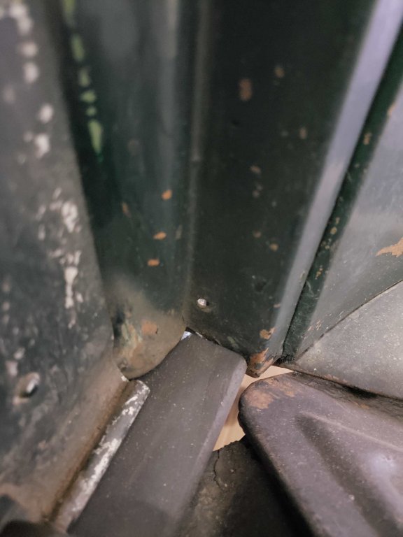

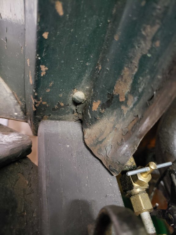

Steve,
Went out quick to snap some shots of mine. Thought I had a definitive answer for you. However, I have a round head screw on the passenger side and nothing on the drivers side. I can tell you this former has not been off the firewall since 1962.. but since it has an obvious green brush paint job from before then, I can not say with certainty the screw has always been there. It is a January 1915 touring body.
