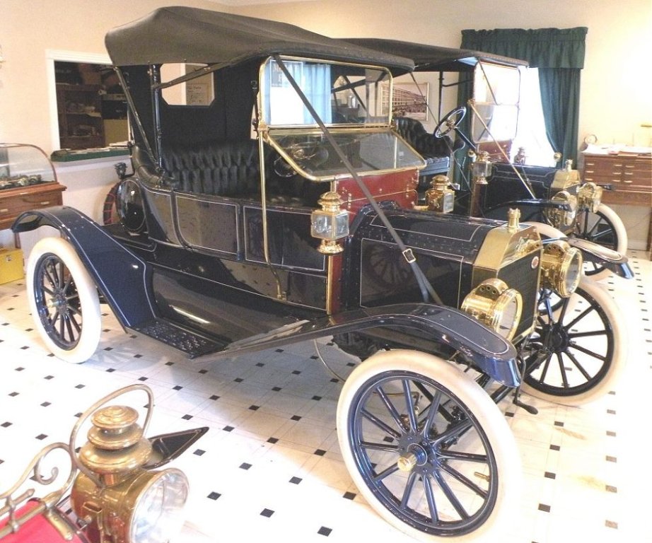

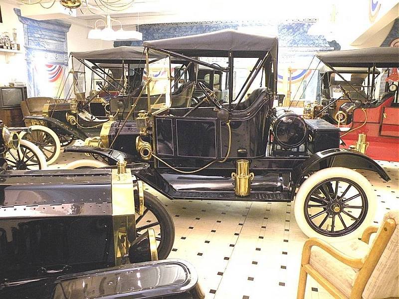

Posts: 6803
Re: New Member wanna B
Post by Scott_Conger » Tue Nov 09, 2021 4:26 pm
Here is a quite correct 1911 Torpedo Runabout...primary identifiers are slanted lower windshield, very short running boards and very low sides on the body
Here is a quite correct 1912 Torpedo Runabout...primary identifiers are vertical windshield, more normal length running boards and higher sides on the body
there are, of course more differences, but if the car you are looking at does not look VERY MUCH like one or the other, then it is not a TORPEDO.
Good Luck
