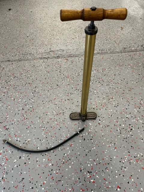

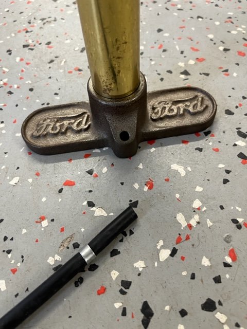

I have this pump that I just installed a rebuild kit in. I am missing the fitting on the base to connect the hose to. Does anyone know where to get one?

I got this pump to go with my '26 touring. Probably not correct with the brass body but I like it. I tried to determine the size. First glance just figured 1/8" pipe, but way smaller than that. 1/4" fine slips in, 5/16" too big. Got it in my mind that it might be the same size as a valve stem. Acts like wants to start in but doesn't. Threads may be dinged but I didn't want to go too far until I knew for sure.

I have the same pump, or maybe an excellent reproduction, and it has no check valve. The chuck should have no center post, so the tube stem serves as a check valve.

I found a few in my odd box, closest one is a 5/16” x 24 NFT with a check valve. I do have one only of the odd 9/32” x 32 NFT with no check valve. $12.00 each plus shipping.
